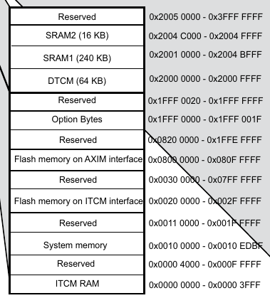

Oh, I see. Yes, Flash on the TCM bus starts at 0x0020 0000:
MM..1
December 14, 2020
Yes but read too page about boot modes, you need program option bytes BOOT_ADDR for start from TCM
Normal default boot is i mean 0X0800 0000

In fact, the flash is aliased on 0x00200000, but the RM says explicitly
"64-bits ITCM interface:
– It is connected to the ITCM bus of Cortex-M7 and used for instruction execution
and data read access.
– Write accesses are not supported on ITCM interface <--- !!!
– Supports a unified 64 cache lines of 256 bits (ART accelerator)"
That is, for programming the flash, you must specify the address range starting at 0x08000000 (as for all STM32 devices). Depending on the programmer/software you're using, the address range starting at 0x00200000 might not be recognized as belonging to flash at all.

And depending on your programmer, there *might* be an option to use the ITCM-interface addresses for programming, see AN4667.

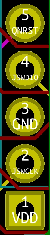

I wanted to test the RESET thing, when I discovered the actual cause of the problems: When I disconnect the J-Link programmer, everything works. If the J-Link programmer is connected, the STM32 doesn't start. If I remove the NRST wire of the connected programmer, then the STM32 also starts up.
I'm using SWO without trace, and the J-Link connector is this 5-pin connector:
0693W000006GAp0QAG.pngI doublechecked that the J-Link programmer is connected correctly to this connector, and of course I'm able to flash with this. The above pin is connected to NRST, which also has a 10K pull-up (I guess the built-in pull-up would be sufficient).
So why does the connected J-Link (in particular the NRST wire) prevent the startup of the STM32F746? I didn't have these kind of problems with a F722.

If NRST is pulled low, mcu does not run, regardless of what pulled it low. So this is probably a question to be asked at Segger's support.

I checked the level of the NRST wire connected to the J-Link device, and sure enough, it was LOW. But as soon as I connected the Tref wire with HIGH, NRST also went HIGH.
So my guess is that Vdd in above connector is not properly connected to Vdd, although there is clearly a connection in my layout. Maybe the Tref wire itself broke. I'll check further.
