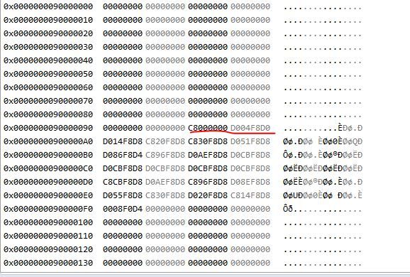

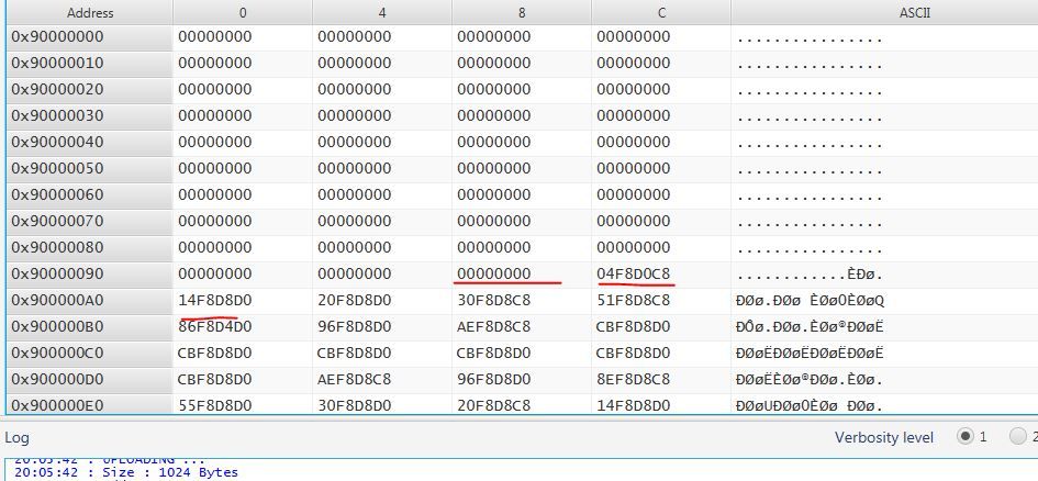

Hello, I programmed STM32F746 Discovery external QSPI flashed using STM32CUBE programmer with external loader option. I can able to see correct data at QSPI Flash when checking with STM32CUBE programmer.
But when I am checking same address using IDE in memory mapped mode, I can see value shifted by 1 byte address. Unable to understand reason. Any suggestion ?

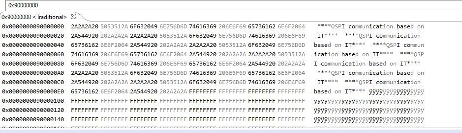

0693W000003OmMAQA0.jpg@Community member​  Hi, I created new project, tried storing some data and later validated in memory mapped mode. Data looks fine in that. Btw I am using  dummy cycles as 10.
