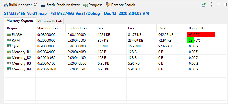

  .textqspi :    <<<<<<<<<< add this  section
    . = ALIGN(4);
    _qspi_start = .;        /* create a global symbol at qspi start */
    *(.textqspi)         /* .textqspi sections */
    *(.textqspi*)        /* .textqspi* sections */
    . = ALIGN(4);
    _qspi_end = .;         /* define a global symbols at end of textqspi */
  } >QSPI AT> FLASH
  /* The program code and other data goes into FLASH */
  .text :
  .ARM.attributes 0 : { *(.ARM.attributes) }
  .textqspi : { *(.textqspi) } >QSPI   <<<<<<<<<<<<<<<<<<<<<<<<<< add this entry
  .RxDecripSection : { *(.RxDescripSection) } >Memory_B1
  .TxDescripSection : { *(.TxDescripSection) } >Memory_B2
  .RxarraySection : { *(.RxBUF) } >Memory_B3
  .TxarraySection : { *(.TxBUF) } >Memory_B4

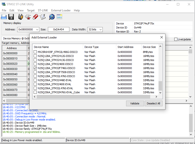

and this setting N25Q128_STM32F746-DISCO
the compile phase now it is ok
I see the QSPI data in the STM32746G_Ver31.map
but I get the error during the flash phase of the external QSPI

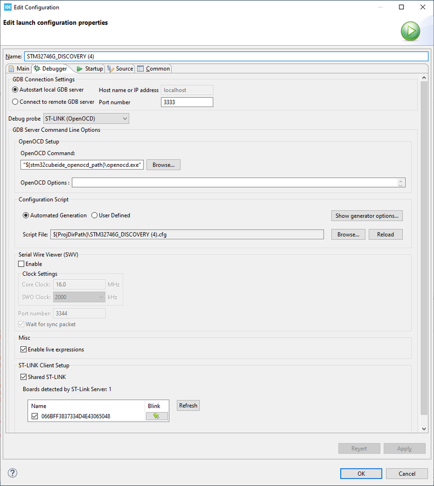

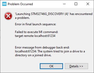

Failed to initialize external memory!
Error in initializing ST-LINK device.
Reason: Unknown. Please check power and cabling to target.

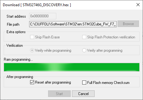

 solved with ST-LINK Server and this settings
1 REPLY 1
Ciuffoly
Senior
Using the ST-LINK outside the CubeWorkspace it run
0693W000006FZNTQA4.pngand I see the value "pippo"
