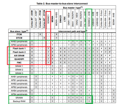

@Sasa1234 wrote:
  • Should SD buffers be placed in a dedicated MPU region?
I don't have idea about how the SDMMC drivers have been implemented but, the data need to be located in region accessible by the SDMMC and that depends on which instance you are using SDMMC1 or SDMMC2. From the RM0399:
For example if the SD data to transfer are located in DTCM, the transfer won't be performaed as the SDMMCs have no access to that memory. So you need to check from your side.
