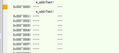

sasami
Thank you for your reply. I followed your advice and changed copytest() to the following, but the flash write on line 28 did not occur.
(I immediately checked the address value in disassembly, but it showed "----" and could not be obtained, so I concluded that this was the case.)
Also, a HardFault occurred when reading(line 33).

LCE
Principal II
You can only erase complete blocks, so 128 kB.
I don't like this for use as a "quasi EEPROM".
But that depends on your use case.
> HAL_FLASH_Program(0x00
You must write the entire flash word at a time. 0x00 is not a valid argument here. It must be FLASH_TYPEPROGRAM_FLASHWORD.
> m_addrTest
This variable is never initialized. What is the purpose of "getTestWord = m_addrTest" here?
sasami
Thank you. Due to circuit limitations, it is difficult to add additional flash memory. The starting address of m_addrTest is 0x08080000, so I thought I could retrieve the data written with
HAL_FLASH_Program(FLASH_TYPEPROGRAM_FLASHWORD, (uint32_t)MEM_STARTADDR, testWord);
by setting "getTestWord = m_addrTest".
Is there any other good way to retrieve the data?
