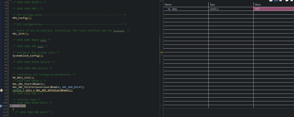

But I created a minimal example with CubeMX similar to @Kamil Duljas​ and with this it works.
I will now compare the two projects and get back to you if I find the cause of the problem.
Thank you for your help!

Now it works!
I have found two errors:
1. __HAL_RCC_ADC1_CLK_ENABLE() was not called. So ADC1 never worked with my posted code, I confused that with ADC3
2. There was a wrong configuration in SystemClock_Config() because the code was ported from an STM32F722 which used some other peripherals. This somehow never caused problems until now
