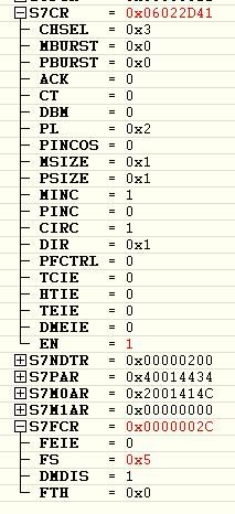

Post the relevant DMA registers' content.
andre239955_st
Posted on July 08, 2016 at 10:27
Ok, here we go:

andre239955_st
Posted on July 08, 2016 at 10:34
I just made a small change: instead of reprogramming TIM10->CCR1 I used TIM2->CCR1. This one works... So I tried using a different timer, TIM5. This is also working. So it seems that I am not allowed to use TIM10's CCR1 as destination? Extremely strange...
AR
andre239955_st
Posted on July 08, 2016 at 10:48
More testing done. I have discovered that it only works with some timers:
TIM2, TIM3, TIM4, TIM5, TIM12, TIM13 and TIM14.
All the other timers generate the error! I guess ST has some digging to do...
AR
Posted on July 08, 2016 at 11:39
TIM2, TIM3, TIM4, TIM5, TIM12, TIM13 and TIM14. All the other timers generate the error! I guess ST has some digging to do...
Which are all, unsurprisingly, on APB1...
