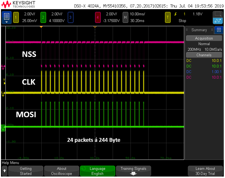

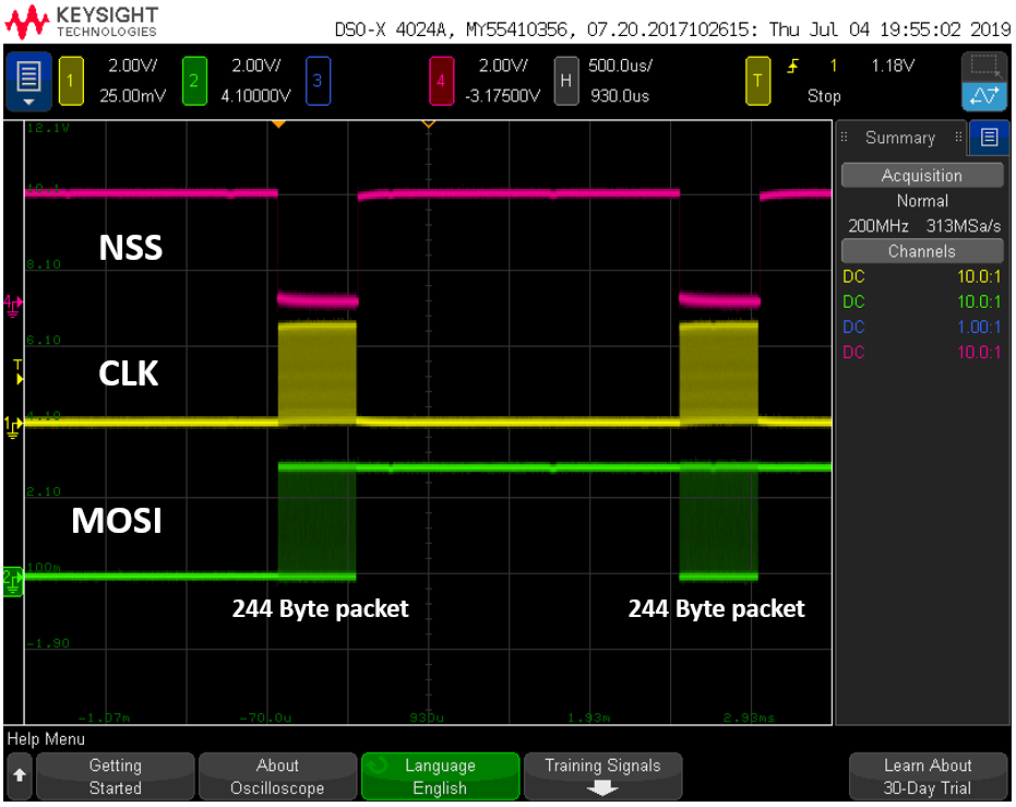

Due to the SPI transfer.
Attached are 2 oscilloscope captures of a 5800 byte (netto) (5856 byte brutto to fill up the 24th packet) frame transfer.
So all data will be transfered every time. I checked that several times.

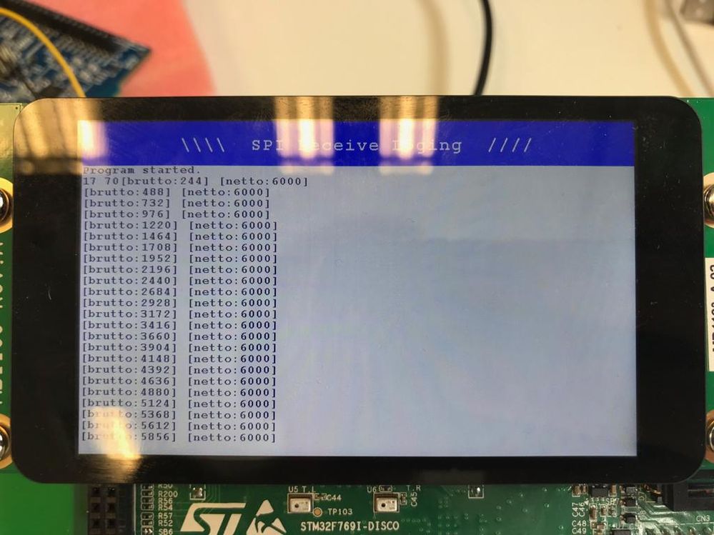

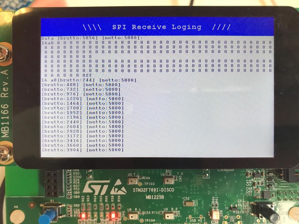

AWent
These are snippets of my SPI Receive log (print command).
I only print the first and the last 2% of the data, otherwise the printing would take too long.
Here I transfered 5800 byte netto (5856 byte brutto to fill up the 24th acket again).
First the transfer worked fine.
Then the MCU hang up while receiving the next data frame.
A 6 kByte data frame wouldn't even work at the first transaction. It hangs up immediately.0690X000009YQ5zQAG.jpg
By the way: The dummy data I transfer is just a counter counting up in every byte. Just the first byte is the net amount of data. And the last byte is a 0xFF to indicate the end of the dummy frame.

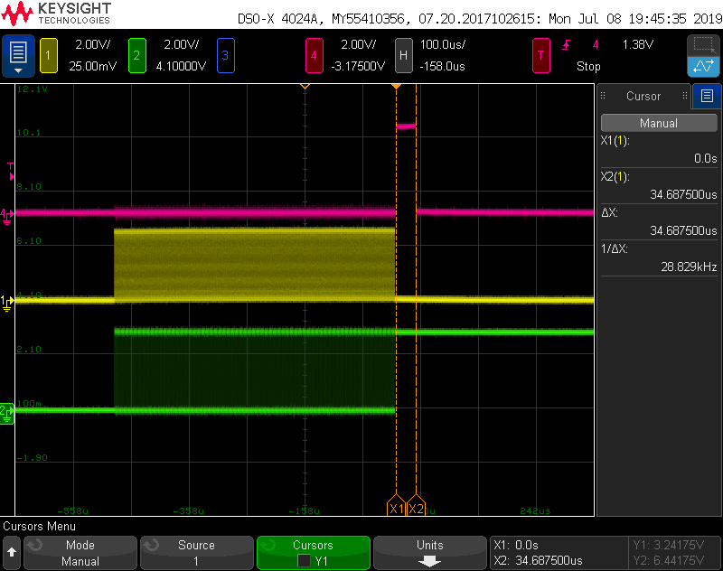

@Alex R:
I will measure the runtime of the Callbacks and let you know.
Do you really think the SPI transfer is too fast already?
I already added an additional 2ms delay between each SPI packet at the transmitter side. And I only send frames every 2 seconds for now. In the end that should be a lot faster with several frames per second???
I thought I am using SPI with DMA, don't I?
I thought the HAL_SPI_TxRxCpltCallback is a DMA Callback function?
Which has some good and some bad features... I standardized the packet size to 244 Bytes, yes. However, the frame size could vary from 3-6kByte depending on the applications data size later on.
Like the Oscilloscope capture shows, the Calback only takes about 35us.
