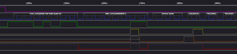

I am here again to ask for your help :)
I am using a STM32F767ZI Nucleo Board and connected a Winbond W25Q64JV using the QSPI interface of the MCU. Everything is working fine so far - I can read data in every mode described in the data sheet (even Fast Read Dual I/O), and write data even in the Quad Input Page Program mode.
The only thing not working at the moment is reading data in Fast Read Quad Out or Fast Read Quad Input mode. The data returned by the Winbond memory chip is not correct.
The only thing I do is checking in the registers that the QE bit is set correctly - which it is.

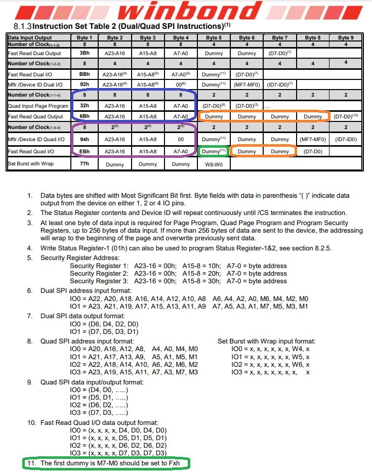

Doesn't 0xEB command expect an 0xF* value in the Alternate byte
Or use try using 0x6B with the ADDRESS in 1-bit, and 8 dummy cycles

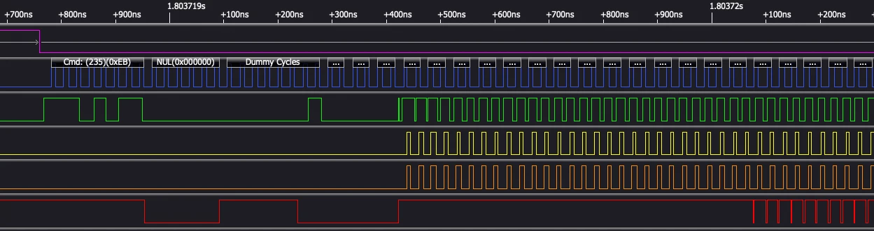

I had the same problem as you and I did make changes to the function to implement the 0xFF for the first Dummy cycle, however the main difference that finally succeeded was to change my Prescaler and Chip Select high time. What I found was with a clock rate of 80 MHz and my values set as below I was able to rectify my issues.
hqspi.Instance = QUADSPI;
hqspi.Init.ClockPrescaler = 1;
hqspi.Init.FifoThreshold = 1;
hqspi.Init.SampleShifting = QSPI_SAMPLE_SHIFTING_NONE;
hqspi.Init.FlashSize = 23;
hqspi.Init.ChipSelectHighTime = QSPI_CS_HIGH_TIME_5_CYCLE;
hqspi.Init.ClockMode = QSPI_CLOCK_MODE_0;
Mathematically I should have been ok with a ChipSelectHighTime set to 4, which I had it set to for most of my troubleshooting, but in the end I bumped it to 5 and that completely solved my issue. I experimented and set it higher and that works fine too, but 5 is stable and optimal. Also as well, setting the prescaler high to reduce the frequency the chip communicates at has a negative effect on stability as well. It is good to finally get it to work and then to test its boundaries.
My final function is below for my W25Q128JV. Hope some of my solutions help.
