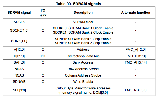

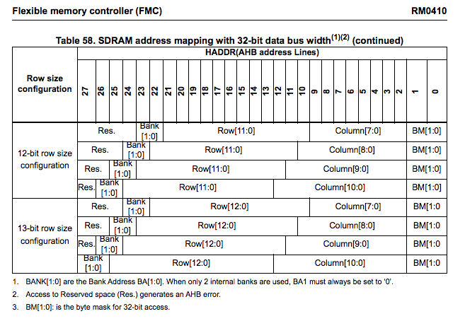

I noticed two things by re-reading the RM :
Here I see that BM[1:0] is a byte mask for 32-bit access.
And here :
FMC_NBL[3:0] Seems to be related to my issue as well.
I can't figure out what you mean by BYTE LANES. I assume it is related with what is above. Could you enlighten me a little more?

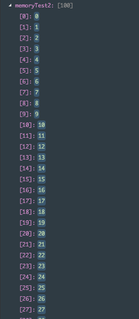

Here is what I get when I try to write UINT32 elements in SDRAM set to 32b width (Code in my previous post) :
As you can see, everything's fine.

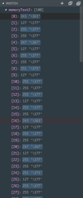

Now here is the result for a uint8 tab :
As always, thanks for your time.

Do i need to do something specific to have those BYTE LANES pins NBL[3:0] to properly mask data when I try to write bytes? I assume it is handled by the FMC, but maybe I have to use exclusively HAL methods to have it working?
2019-04-04 8:35 AM
Post initialization the HAL plays no role, it is a configure and forget set up. You have to setup the pins, controller and memory correctly from the outset.
I'm not going to dig through register level code to validate it. My approach would be to use the verbose HAL configuration methods and examples first, and validate the read/write functionality of the SDRAM array at 8, 16 and 32-bit widths. Once that's done I'd migrate to the register level stuff. In the past I've had to do this for a number of DISCO boards because ST only provided code for the EVAL boards.

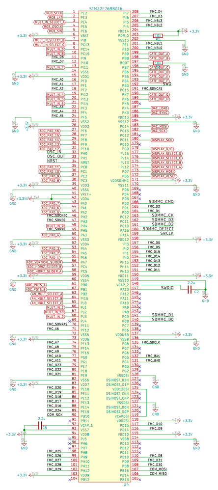

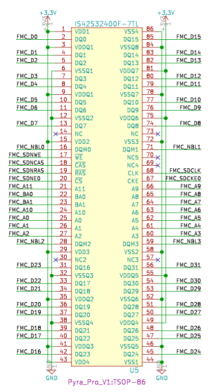

Here is the pinout :

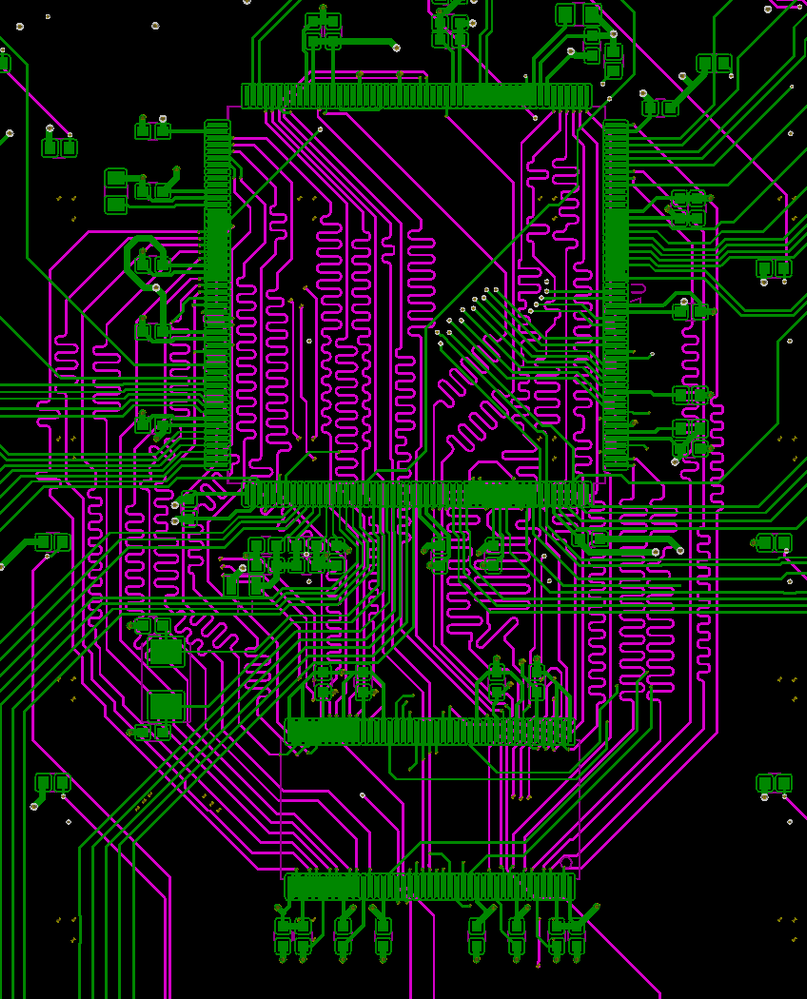

And here is what the length matched traces look like:
2019-04-04 8:48 AM
I set SDCLK to the minimum (3xHCLK periods) and CAS latency to the max to avoid timing problems but results in my tab are the same than before.
2019-04-04 9:59 AM
The pin diagrams here are unreadably small/low-res
Test your memory read/write 32/8-bit code on an STM32F769I-DISCO, see that they work properly there, where the width is managed transparently.
Create your own long-hand form of the HAL's BSP SDRAM code like that for the DISCO, but for your own board. STM32Cube_FW_F7_V1.15.0\Drivers\BSP\STM32F769I-Discovery\stm32f769i_discovery_sdram.c
All the SDRAM settings need to be coherent across the controller, and SDRAM configuration writes.
Set aside your desire to get the SDRAM working at startup, and validate it first using the later stage HAL method.
2019-04-04 10:01 AM
Suggests a more pin level issue. Figure several hours of work to unravel
