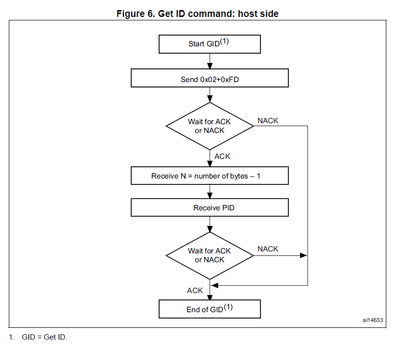

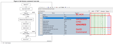

Problem 1 - GetVersionComand (documentation mismatch)
I sucessfully entered in BL (Ack = 0x79), however GetVersion command is totally ignored.
I then tested with another command to see if the communication with embedded BL works.
Something worked but not as expected.
Command 0x02+0xFD should reply with ACK(0x79) + N=NumberOfByte + PID. I did not see 0x79 as ACK nor the number of bytes i should get: i just got 0xD0 and 0x94.

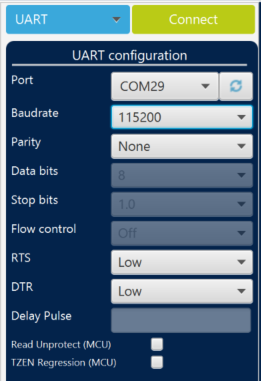

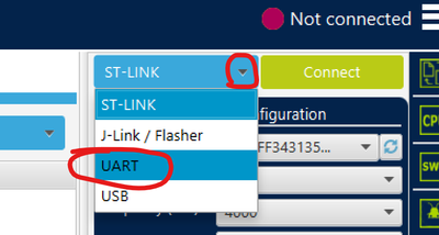

Hello @Davide Dalfra
I've tested using the STM32CubeProgrammer V2.19.0 and the NUCLEO-WB09KE. I've set the JP1 of the MB2032 to bootloader mode, connected the board throw the STM32CubeProgrammer, set the connection parameters as follow (with no parity):
Finally, click on connect and on the HW reset button of the board. Everything works fine for me:

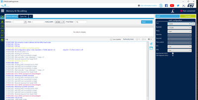

16:30:03:448 : UR connection mode is defined with the HWrst reset mode
16:30:03:452 : RTS low
16:30:03:453 : DTR low
16:30:03:462 : Serial Port COM29 is successfully opened.
16:30:03:462 : Port configuration: parity = none, baudrate = 115200, data-bit = 8,                     stop-bit = 1.0, flow-control = off
16:30:03:463 : No Init bits value is : 0
16:30:03:463 : Sending init command:
16:30:03:463 : #byte 0x7F sent successfully to target
16:30:07:463 : Wait ends after 2 loop, dataready = 0, delay = 4000
16:30:07:465 : Timeout error occured while waiting for acknowledgement.
16:30:07:465 : No response from target received
16:30:07:465 : Retrying UART init connection...
16:30:07:466 : #byte 0x7F sent successfully to target
16:30:07:468 : Wait ends after 1 loop, dataready = 1, delay = 0
16:30:07:468 : #ack Received response from target: 0x79
16:30:07:468 : Activating device: OK

I think the problem on your side is to use the even parity.
Best Regards.
STTwo-32

Even parity?
STM32CubeProgrammer can access the bootloader over UART, I'd try that.
Yes even parity and with STM32CubeProgrammer first.
I go "manual" because i was getting peanuts from Cube so i wanted to understand.
By enablihng Verbosity level 3 on STM32CubeProgrammer i'm getting the same results (ack missing).
07:59:37:428 : UR connection mode is defined with the HWrst reset mode
  07:59:37:431 : RTS low
  07:59:37:431 : DTR low
  07:59:37:438 : Serial Port COM3 is successfully opened.
  07:59:37:438 : Port configuration: parity = even, baudrate = 115200, data-bit = 8,                     stop-bit = 1.0, flow-control = off
  07:59:37:438 : No Init bits value is : 0
  07:59:37:438 : Sending init command:
  07:59:37:438 : byte 0x7F sent successfully to target
  07:59:37:439 : Wait ends after 1 loop, dataready = 1, delay = 0
  07:59:37:439 : Received response from target: 0x79
  07:59:37:448 : Activating device: OK
  07:59:37:448 : Board       : --
  07:59:37:448 : Sending GetID command and its XOR:
  07:59:37:449 : byte 0x02 sent successfully to target
  07:59:37:449 : byte 0xFD sent successfully to target
  07:59:37:452 : Wait ends after 1 loop, dataready = 1, delay = 0
  07:59:37:452 : Received response from target: 0xd0
  07:59:37:452 : Error: GETID command not acknowledged!
  07:59:37:552 : Reemission of GetID command
  07:59:37:552 : Sending GetID command and its XOR:
  07:59:37:553 : byte 0x02 sent successfully to target
  07:59:37:553 : byte 0xFD sent successfully to target
  07:59:37:553 : Received response from target: 0x94
  07:59:37:553 : Error: GETID command not acknowledged!
  07:59:37:652 : Reemission of GetID command
  07:59:37:652 : Sending GetID command and its XOR:
  07:59:37:652 : byte 0x02 sent successfully to target
  07:59:37:652 : byte 0xFD sent successfully to target
  07:59:37:653 : Received response from target: 0xd0
  07:59:37:653 : Error: GETID command not acknowledged!
  07:59:37:838 : Chip ID: 0x0
  07:59:37:839 :  UART PORT CLOSE
  07:59:37:840 : Disconnected from device.
  07:59:37:840 : RTS low
  07:59:37:840 : DTR low
  07:59:37:845 : Serial Port COM3 is successfully opened.
  07:59:37:845 : Port configuration: parity = even, baudrate = 115200, data-bit = 8,                     stop-bit = 1.0, flow-control = off
  07:59:37:845 : No Init bits value is : 0
  07:59:37:845 : Sending init command:
  07:59:37:846 : byte 0x7F sent successfully to target
  07:59:41:845 : Wait ends after 2 loop, dataready = 0, delay = 4000
  07:59:41:845 : Timeout error occured while waiting for acknowledgement.
  07:59:41:845 : No response from target received
  07:59:41:845 : Retrying UART init connection...
  07:59:41:846 : byte 0x7F sent successfully to target
  07:59:41:847 : Wait ends after 1 loop, dataready = 1, delay = 0
  07:59:41:847 : Received response from target: 0x1f
  07:59:41:847 : Activating device: OK
  07:59:41:847 : Board       : --
  07:59:41:847 : Sending GetID command and its XOR:
  07:59:41:847 : byte 0x02 sent successfully to target
  07:59:41:848 : byte 0xFD sent successfully to target
  07:59:41:848 : Wait ends after 1 loop, dataready = 1, delay = 0
  07:59:41:848 : Received response from target: 0xd0
  07:59:41:848 : Error: GETID command not acknowledged!
  07:59:41:955 : Reemission of GetID command
  07:59:41:955 : Sending GetID command and its XOR:
  07:59:41:955 : byte 0x02 sent successfully to target
  07:59:41:956 : byte 0xFD sent successfully to target
  07:59:41:956 : Wait ends after 1 loop, dataready = 1, delay = 0
  07:59:41:956 : Received response from target: 0xd0
  07:59:41:956 : Error: GETID command not acknowledged!
  07:59:42:055 : Reemission of GetID command
  07:59:42:055 : Sending GetID command and its XOR:
  07:59:42:057 : byte 0x02 sent successfully to target
  07:59:42:057 : byte 0xFD sent successfully to target
  07:59:42:057 : Wait ends after 1 loop, dataready = 1, delay = 0
  07:59:42:057 : Received response from target: 0xd0
  07:59:42:057 : Error: GETID command not acknowledged!
  07:59:42:156 : Chip ID: 0x0
  07:59:42:157 :  UART PORT CLOSE
Best Regards.
STTwo-32
Ahh, it's right there in AN2606. Had no idea some chip bootloaders used no parity instead of even.
Looks like this is limited to STM32WB0x products, all others use even parity.
@STTwo-32 Thanks for chasing that down.
Hello guys
Yes was the parity setting. I used to give this as always parity as on other BL.
Thanks all for the support
