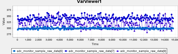

The input data from channel 1~9 are quite normal and can auto-update all the time. Channel 14 and 15 can also auto-update but it didn't read the correct voltage. Like even a 3.3V input, its ADC value would still around 300. Check below, the array adc_monitor_sample_raw_data[6], channel 9 is still correct and stable but [7], [8] (channel 14, 15) are not.

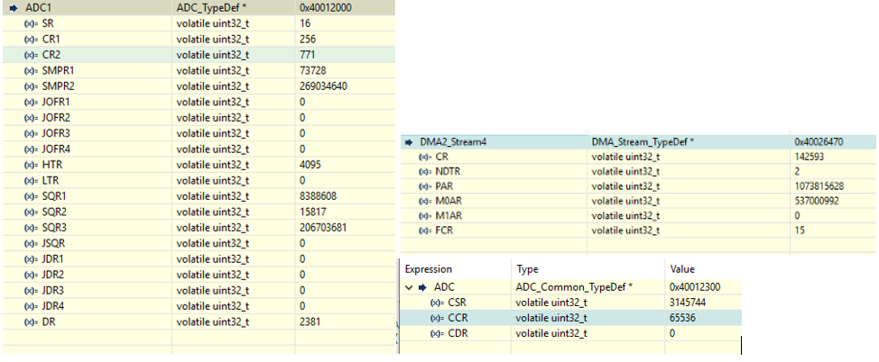

However, a strange thing is I tried with CubeMX, used HAL Driver @1.7.10, called HAL_ADC_Start_DMA() to do the same thing. It worked! But I compared every register bits of ADC, ADC1 and DMA after initialization, no big differences (except some useless interrupt settings because both IRQhandler are not defined) but still don't work. Though after I also configured interrupt and made 100% same as HAL Driver, NO HELP.
How about the GPIO registers? That's a lot of noise. Looks like the pins might not be in analog mode.
Registers don't lie. Gotta be an answer somewhere in there.

Thanks a lot! It is the GPIO setting, I also copied the macro pin name when init GPIO.
