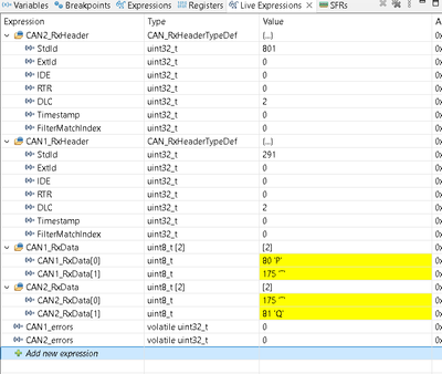

@Davaol19 wrote:
But i'm not very familiar with loopback mode.
Ok. It's time to start to be familiar with it. It's simpler than Normal mode as it doesn't need any external HW and it's needed for cases like yours for debug.
You can inspire from this example provided in the CubeHAL: https://github.com/STMicroelectronics/STM32CubeF4/tree/master/Projects/STM32446E_EVAL/Examples/CAN/CAN_Loopback
Attached a project I made for Nucleo-F446RE board:
CAN1 and CAN2 are in loopback mode. Nothing connected externally. Activated all the possible CAN errors.
Nothing happened, CAN1 and CAN2 "transceive" both the frames correctly and none of the activated errors has raised.
Please run this FW on your board, open the "Live Expressions" and check especially CAN1_errors and CAN2_errors.
As you can see from my debug session screen shot, CAN1 and CAN2 are receiving messages in loopback mode without errors:

@Davaol19 wrote:
think thats the problem maybe can't be sen in this mode due to the fact that acknowledge bit is ignored.
The no direct acces to sram in CAN2 could be a problem?
You said you have an issue when you enable CAN2 and you suspected an issue with CAN2 implementation in STM32. Loopback mode is the best test to know on which location the issue resides. If you didn't reproduce the behavior on your board with the FW I provided, I'm pretty sure you have an issue with your CAN HW including the transceiver. So please do that in order to converge to a solution.
So please make the test and het back with the result.
Thank you.
I've tried your code in my PCB and the behavior is exactly the same as yours.
Tomorrow i will change the mode to normal in your code and try to connect both peripheral between them.
Thanks you
Thanks you
From this, I conclude this is not an issue on the STM32 but in your hardware.
Try to replace the transceiver either the same part number or completely use another part number example SN65HVD230 what we are using in our Eval boards.
