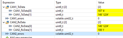

Attached a project I made for Nucleo-F446RE board:
CAN1 and CAN2 are in loopback mode. Nothing connected externally. Activated all the possible CAN errors.
Nothing happened, CAN1 and CAN2 "transceive" both the frames correctly and none of the activated errors has raised.
Please run this FW on your board, open the "Live Expressions" and check especially CAN1_errors and CAN2_errors.
As you can see from my debug session screen shot, CAN1 and CAN2 are receiving messages in loopback mode without errors:
