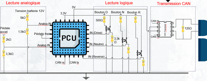

ok sorry let me be explain myself.
Here is the schematic of my ECU prototype. I am using the CAN protocol to communicate with peripheral in the car.
The PCU on schem represents the F446RE
When i connect this guy onto the CAN bus, after setting the CAN transmission speed, setting the normal mode and enabling the interrupts, i am trying to debug my program.
Everything is fine until i reach the function of initialization of CAN "HAL_CAN_Init(&hcan1)". In this function, at the end, before the return value, the hcan->State variable should be set as "HAL_CAN_STATE_READY". This is ok but when i reach that line : "hcan->State = HAL_CAN_STATE_READY;" the expression of window shows me that the value is not set as HAL_CAN_STATE_READY, as expected, but as HAL_CAN_STATE_LISTENING. I don't know the reason.

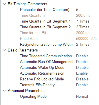

Furthermore, here is the setting of the CAN on the .ioc file.
2024-08-29 5:31 AM
Thank you for these details. Meanwhile you didn't provide the schematics but a sketch. What transceiver you are using?
Also, you didn't give details about CAN bus. What and how many nodes are connected to the bus? and how you connect your node to the bus? hot plug?

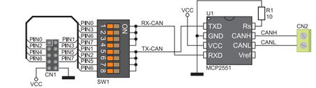

Well, the tranceiver i am using is a MCP2551:
A battery management system, an engine, a cluster, and a DC/DC converter are connected to the bus. I am connecting this system to the bus using a connector i don't know the reference. See:

1- The part of the transceiver schematics is not clear to me.
