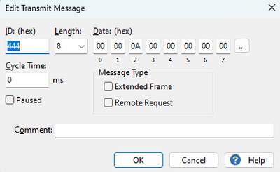

I am trying to make FDCAN work but I am not receiving any messages. The TX is working fine but when trying to receive messages the interrupt is not triggered. I am using STM32H7 series with freertos.
I have set the filter, started FDCAN, enabled interrupts, activated notifications,.. Any idea what I have missed?
Even when using external loopback, I can see the messages being sent but the interrupt is not triggering.
This is my code:

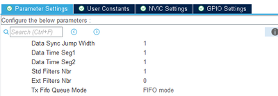

Thank you for your help. I have found the issue. I had filter definition but in the .ioc file my Std Filter Nbr was set to 0 since I forgot to set it. It works fine now!

since I am using TouchGFX i figured it seems appropriate.
I was calling it in the task and in the callback because I wanted to test it since it never gets to the callback because interrupt doesnt trigger. I have later removed it from the task and left it only in the callback.
Clock source selection: TIM6 with HSE crystal/ceramic resonator
Filter configuration:

The message Im trying to send to trigger the interrupt looks like this:
The filter seems to be correct and data is being sent to the PCAN-View so I know that hardware communication is fine
