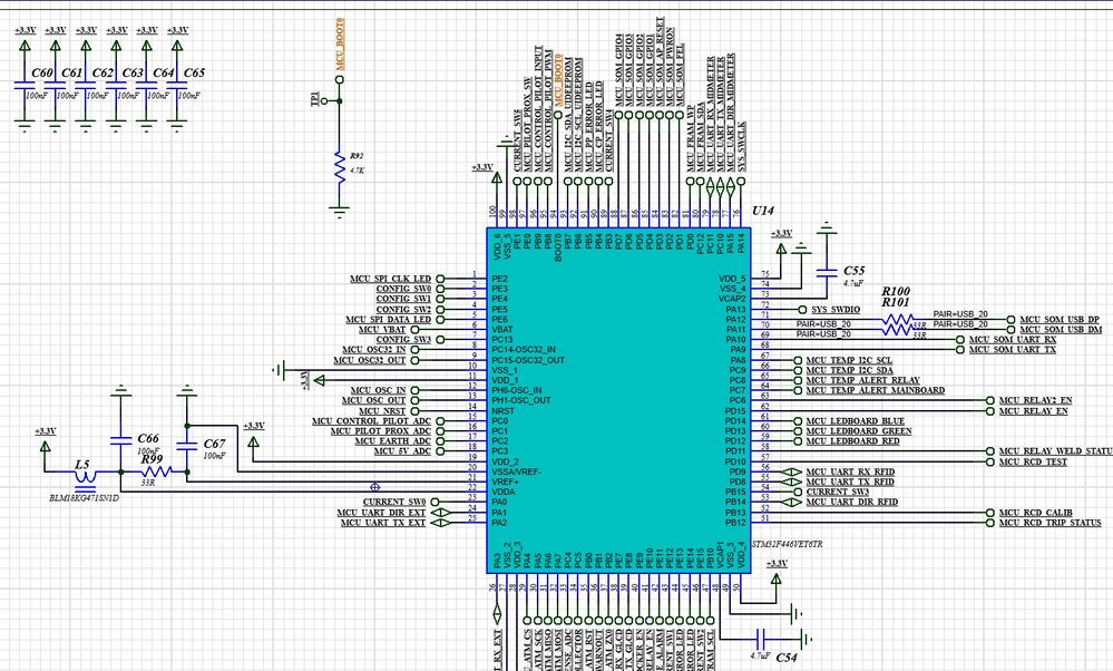

Thank you in advance for your assistance.

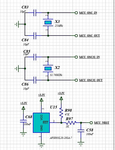

I have designed a circuit with STM32F446. I am using an external 25MHz crystal. The main application program runs fine without any issues, and USB communication works. However, on some boards, I am unable to put the processor into USB DFU mode. I have several boards, and most of them enter DFU mode correctly. I am controlling the Reset and Boot pins externally with another microcontroller. I am monitoring the NRST and BOOT0 pins with an oscilloscope, and there seems to be no problem.
I have also tried using a 10MHz crystal with 20pF capacitors, but still couldn't get the processor into DFU mode. I even tried the UART bootloader method by disconnecting the USB cable, but I still fail to get a response from the processor to the 0x7F command.
As mentioned earlier, DFU mode works perfectly fine on many other boards. However, despite checking everything, I am unable to put the processor into DFU boot mode on some boards.

Since you say you can reliably get DFU working/non-working with heat, do you have the means to localize temperature differences (aluminium tape/heat shielding, a heat sink, a thermal pad, freeze spray), to try and identify which part in particular is showing the relevant heat-dependent behaviour? is it the STM32 or your crystal?
Do you have a alternative source of crystals (different freq, make, distributor)? Can you source some over-spec crystals and hand solder them with low-melt solder to see if this fixes the board? if it does, it may be the crystal.
I fuzzily recall that some crystals with integrated capacitors actually may still require external capacitors as well in the fine-print, have you been through the datasheet carefully?
ST's AN2867 is dedicated to working with oscillators, have you gone over that?

‎2024-06-25 2:23 AM - edited ‎2024-06-25 2:24 AM
@Ugnas wrote:I found the issue...
It was BOOT1 pin left unconnected. I connected it directly to ground. DFU mode is stable now..
This is instructive for anyone who brings up boards (or helps others do so, on the forum). Instead of going down a rabbit hole of subtle causes, it's often something very simple.
I hope topic author has same, easy issue like me and not all this calibration nightmare :beaming_face_with_smiling_eyes:
actually, you may have pinpointed their issue as well. BOOT1/PB2 is cut off in the schematic image posted, but it looks like it is used as GPIO, and might not have been grounded. Unfortunately, the original poster seems to be MIA so we may never know. Nor will they, perhaps.
