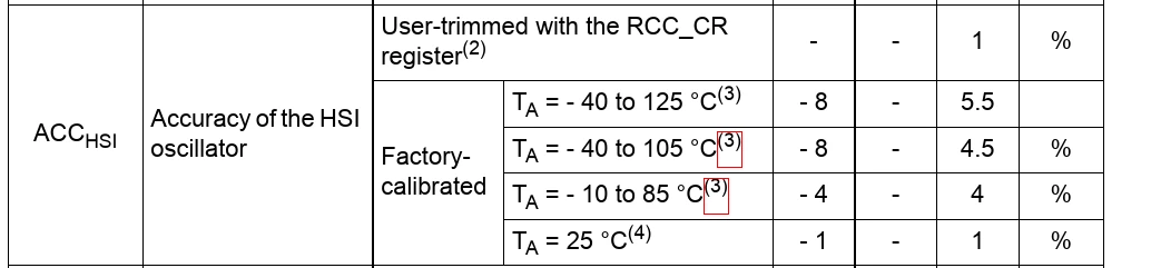

Please see this thread from 2018
https://community.st.com/t5/stm32-mcus-products/stm32f4-hsi-accuracy-drift/td-p/360021
The poster complains that the datasheet claims 1% accuracy for the RC oscillator over full temperature range,
but other sources (such as the intro to AN4067 - Calibrating internal RC oscillators) suggest that  the 1% accuracy is at 25C only (and that this perhaps is only "typical" accuracy).
The claim still appears in in the STM32F4 datasheet when I checked today. I believe this error may has been copy-pasted to the documentation for other product lines.
Sorry, which "error" ?
As from ds (F411) , states: "16 MHz internal RC oscillator is factory-trimmed to offer 1% accuracy at 25 °C.
And in data :
see footnote 4 :
You ever got a chip mounted without soldering ? :)
So its just : +/- 4% , "maybe" better, up to 1%, as calibrated in fab, if you can solder very cool ... :)
And the "error" is ...obscured euphemistic description , that never will be reached in real use ?
don't get snippy with me, boyo.
Which error? This error:
Which is (still) exactly where the thread I linked pointed to, in 2018. As you would have seen, if you had read the thread.
The rest of what you wrote isn't relevant.

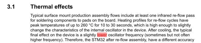

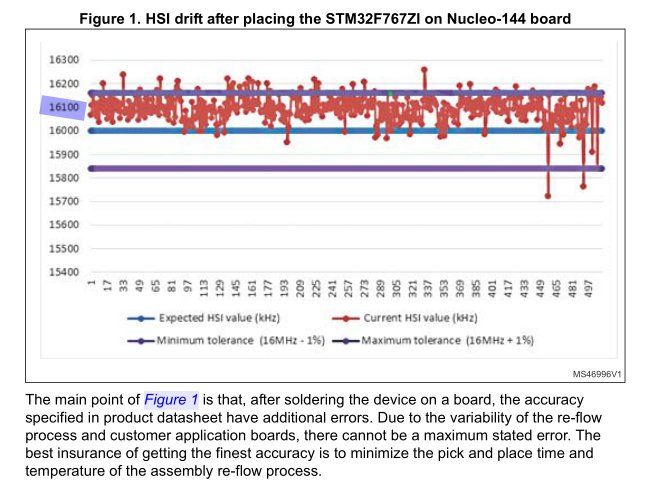

Followup snafu from reading more about this issue (new to me, fascinating):
From AN5067: How to optimize STM32 MCUs internal RC oscillator accuracy
but later in the document
so, you have a graphic of results showing the oscillator frequency is higher (mean of 16.1khz instead of 16Khz),
but the text states the thermal stress causes the frequency to drop. Unless I'm misunderstanding something (which happens), this is a contradiction.
"- If someone's post helped resolve your issue, please thank them by clicking ""Accept as Solution"".- Please post an update with details once you've solved your issue. Your experience may help others."
waclawek.jan
June 23, 2024
...or to rise (half a sentence later).
PS it's 16MHz not 16kHz
BarryWhit
BarryWhitAuthor
Lead
June 24, 2024
Come on. They say "typical effect is lower freq, and sometimes but not often higher freq" and they show 500 sample points from a test, 95% of which are higher in frequency.  There's an obvious contradiction between text and data there.

June 24, 2024
IMO it's not about the deviations of individual frequency readings, but the average, in one specimen. The "typical effect..." etc. means, that the temperature shock during soldering shifts the frequency irreversibly, and in most chips the HSI's average frequency is lower than it used to be before soldering. The shown example is that less common case, where the average is higher. And what.
The point is, that this effect is something ST discovered quite recently,  some10 years after the chips are in manufacture. It's quite understandable: ST does not use them soldered. So they fixed the table with the footnote,  but forgot to fix the text in narrative (which you rightly expect to be fixed, too; but there are much worse things in the docs. Doing docs properly is very hard and very expensive. I'm the last person to defend sloppiness in ST's docs, but these things have to be acknowledged, too.)
PS. One thing worthy of noting on that picture is, that the HSI frequency is fluctuating. It means, the 1% is not just an "initial deviation", but also includes a certain amount of that "permanent fluctuation" (in more serious setting we would talk about jitter, although that's just a fancy yet usually very vaguely defined term, too). And that's entirely uncharacterized, and for a good reason.
[EDIT] I misinterpreted that figure [/EDIT]

June 24, 2024
This sounds like a real stretch. So what you're saying is that when the chips come out of the factory, chips which ST engineered so that the spread is centered around the target nominal frequency of 16Mhz, 95% are even more than .1Mhz above the spec, so that soldering actually makes them better? that's a definition of "typical value" I've never heard of.
Also, look at the captioning (or is it text) right below the graph in the image i posted. "after soldering, Additional errors" and they say soldering effects are unpredictable, so I doubt they design this deviation in on-purpose so customers can dial it just so with the available calibration range. That would be mad. If that were true that would mean that if someone takes great care during assembly (as ST recommends in the text) they would get *worse* results on average without calibration.
Hey, I'm with you. There's no way to put out tens of thousands of pages of technical documentation without tons of errors big and small. I do expect that once someone calls an issue out (and more importantly, succeeds in flagging down someone from ST), it will be corrected within a reasonable time-frame. It shouldn't languish in a thread for 6 years.
