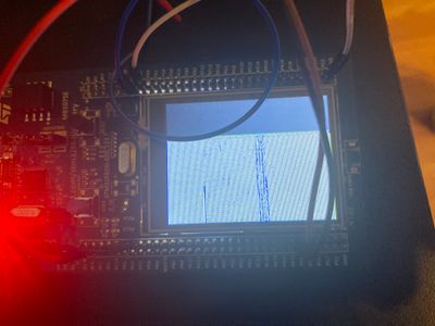

Hello, I'm working on a project on the STM32F429I-Disc1 development board and wanted to use the BSP to write characters to the LCD screen. I used STM32CubeMX to configure with LTDC enabled with the default parameters. Since there wasn't BSP configuration I added the files manually for the LCD BSP which were:

When I run the BSP_LCD_Init function it returns status OK, but after running this line:
LcdDrv = &ili9341_drv; and eventually these three lines in ili9341_Init(void)
ili9341_WriteReg(LCD_SLEEP_OUT);
LCD_Delay(200);
ili9341_WriteReg(LCD_DISPLAY_ON);
/* GRAM start writing */
ili9341_WriteReg(LCD_GRAM);
The screen does this (see attached photo) where it flickers and has this black box on the right side.
I didn't want to change the driver files for the ili9341 so I am assuming something is wrong with my configuration but I wasn't sure how to further troubleshoot this. Does anyone have advice or see any issues of what may be happening?

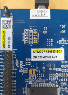

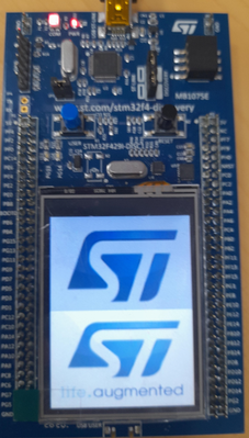

‎2024-08-19 6:55 AM
Hello @jake11212 ,
I tested the BSP and the LTDC_Display_2Layers examples with STM32F429I_DISC1 REV-E01 and I'm able to run these examples without issue as shown in the below figure:
May be your LCD is damaged.
Do you get "Error_Handler();" in HAL_LTDC_Init?
Thank you.

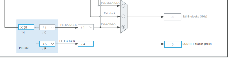

Hi Jake,
I've just had exactly the same issue. I believe the issue is a change in the default clock settings produced by STM32CubeIDE. Try with the above and it should sort it out.
