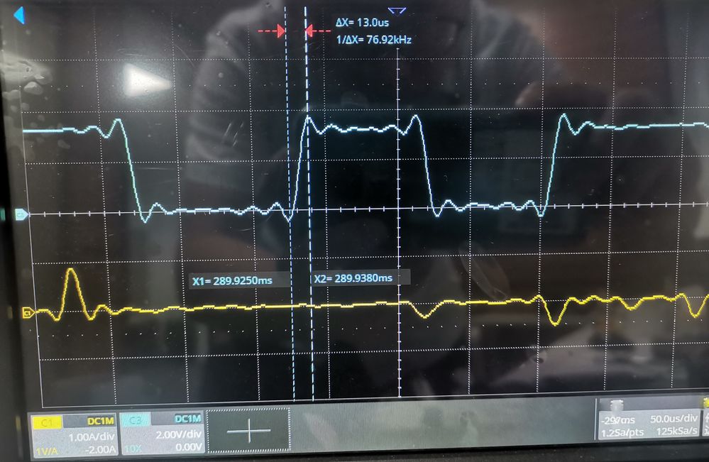

STM32F429 outputs complementary PWM but the waves rise and drop lowly (above 10us)
ausera uirwaij
I'm doing motor drive project and its six pwm signals output from F429 connect with drive IC-- DRV8302 directly, but pwm rises and drops lowly (above 10us) as attached picture. I think this rising time takes too long,is right?
Thank you.
2 REPLIES 2
waclawek.jan
Check the relevant pins' "drive" setting in respective GPIO_OSPEEDR.
