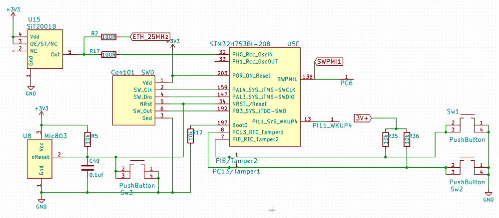

‎2018-04-26 4:44 PM
Definitely sounds like a Reset Issue.
this is my solution, I never have startup issues.
‎2018-04-26 4:48 PM
Honestly i work with stm32f4 as a hobby for some years now, and never used dedicated POR ic for thss, never had such problems like this.
Also each power pin is bufferd by a 1uf tantal cap
I wil double check the resistor on the reset pin, is there any typical value for this?

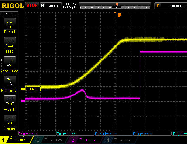

‎2018-04-27 7:27 AM
Bellow is a scope image, yellow is the 3.3V supply line, and purple is the reset pin.
The measurements where taken at 500uS/1V division.
I dont have capacitor on the reset pin
What do you think?
‎2018-04-27 7:06 PM
I would say you definitely need a cap, is that 1uSec from power supply at 2.5v to Reset up ?
did you check the reference manual ?
page 29 of the F427 data sheet, VACAP has to be stable before Reset, can you check that ?
you should check pages 25-29
Page 97, NRST Pin
page 138: You need a 0.1uF, and no resistor ??
Table 59. NRST pin characteristics shows:
Time of NRST_OUT Generated reset pulse duration Internal Reset source 20 - - μs
I can't see this 20uS running on your scope.
page 222
Appendix A Recommendations when using internal reset OFF
