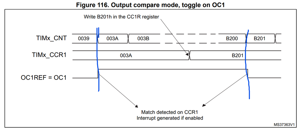

As far as I know, output compare mode keeps a value in timer registers and when counter value matches with the value in the register, then the pin generates an output according to the behaviour the user specify.
I am learning these concepts so that's why I am using output compare. I do not need pwm signal for now.
I hope everything now is correct and dont misunderstand something about these concepts. I looked at reference manual and knew these modes of timers. I then wanted to use it now am trying to implement.

Sory for that, KY017_Module_Init function does the pin configuration, if I didn't do anything wrong.
Actually I could do this with ISR but I dont wanna do with that way if I can do this without any line of code, and I saw that there are lots of video on YouTube that they toggle LED with output compare mode.
Because as I said, this is not a big project. I made this up my mind to learn timer modes. I am planning to work with PWM later to learn that as well. But as far as I know, PWM is used for generating analog signal according to Ton/T, right? Why should I use PWM to toggle an LED? Maybe I miss a point about PWM and I am sure you are completely right for this issue and please let me know if so that I can try this way also later.
