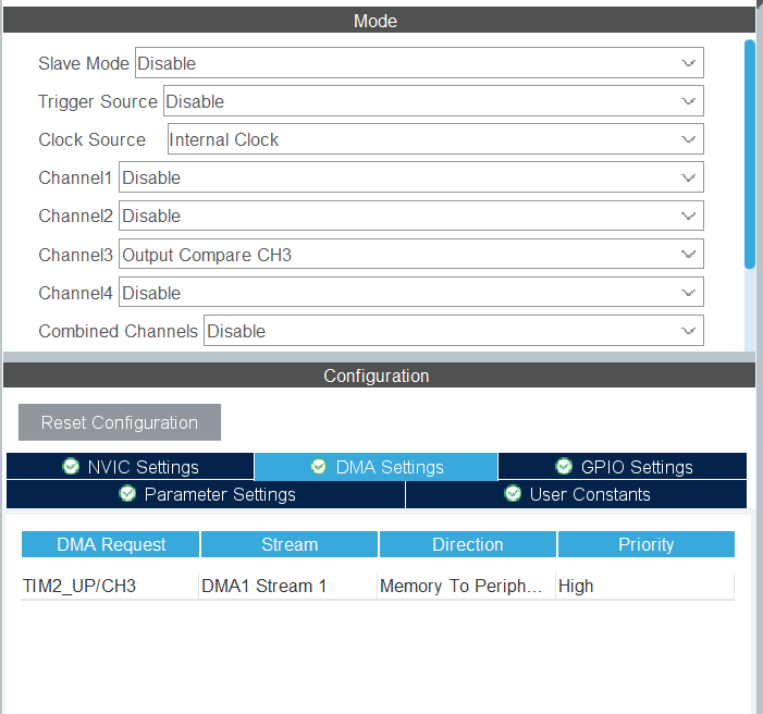

Hope you're well. I want to create a waveform using a Hardware Timer and DMA. Upon looking at other posts in the forum, it seems the best approach from what I have seen is to use a Timer in Output Compare Mode along with a DMA to transfer the pulse/waveform data from memory to the compare register.
Using a discovery board (STM32-F4), I set up timer 2 channel 3 in output compare mode to toggle and also DMA in circular mode to transfer half-words from memory to peripheral. And I initialized with HAL_TIM_OC_Start_DMA(). However, there is no observed changes on the output pin.
I have set up CubeMX as shown below and attached is the generated code. I appreciate any help setting this up, thank you.

Thank you for the example. I have studied it and I am not sure that I understand the PWM Implementation in this instance, as after reading the reference manual it seems that the duty cycle can be changed but not the period. Perhaps, I should have added more comments in my example but what I am trying to accomplish is similar to a PPM signal. Below is a reference but my application does not need ADC ... thank you!
https://community.st.com/t5/stm32-mcus-products/stm32f100rb-dma-timer-ppm-stream-solved/m-p/432548
Be more specific here. What kind of waveform do you want? What do you want to vary?
I want to generate a simple wave form that resembles a PPM signal.
| 1000 us | 500us | 1000us | 500us | 500us | 2000us | end of toggle after period is over
Basically, i want to toggle when the timer count has elapsed for each of those values in the array.
The example provided above can serve as a starting point, except that you should use HAL_TIM_Base_Start_DMA to start the timer instead of HAL_TIM_PWM_Start_DMA. This will update the ARR register with the array values at every cycle. Start the channel prior to this call and set it to toggle the pin on update.
