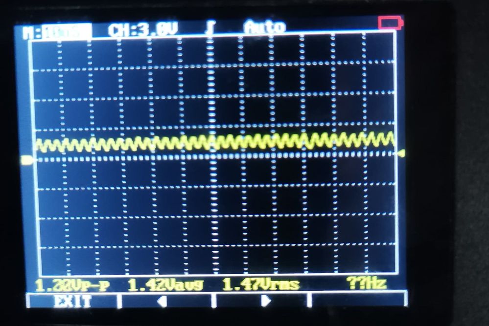

So I have been developing my custom board, based on the STM32F407VE chip, and have encountered an issue with the SPI1 bus. I was trying to set up an SD card module on the bus, using the SdFat library by Bill Greiman. I specified the CS pin to be PA4, which is the default CS for the SPI1 bus. Below is the connection diagram, as well as the chip's SPI1 bus pinout for reference. 0693W00000bhKsvQAE.png0693W00000bhKsqQAE.pngThe SD card fails to initialize, in particular, SPI library throws a timeout right here.

The voltages on the SPI pins are very low, below 2V, although everything on the board is running on 3.3V. However, the I2C buses and other peripherals operate just fine, so power supply related issues seem unlikely.
Also, the clock signal looks not how a clock signal should look like.
0693W00000bhKsrQAE.jpgAt first, I thought I might be running it too fast, and attempted to lower the clock speed:
SPI.setClockDivider(255);
But it doesn't seem to even work. It doesn't seem to affect the frequency of the SPI clock signal at all.
I will be happy to provide any additional details, and grateful for any help in getting this thing to return a true.
SD.begin(SD_CS_PIN)

Look at the signal levels without a card in the socket.
Review the other end of the circuit.
ASoli.2
Without the card:
Clk 1.5V
Mosi 3V
Miso 0V
Cs 3V
​And with:
Miso 2V
Clk 1.5V
Mosi 3V
Cs 3​V, I've tried 3 different cards, 2 of them timeout in the same way, and one sometimes, around once every 2 attempts passes the block of code I posted above and fails on the next one, which is supposed to read some card ID register. It is super weird.

maybe you try: set pin speed low, to reduce reflections on the lines to sdcard.
Wondering about the quality of the scope/grounding
