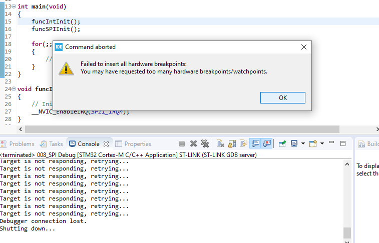

Hi
I am using the STM32F407 discovery board. Yesterday evening, I tried to init the SPI1. Then something strange happened. I suddenly receive the error message "Fail to insert all hardware breakpoints: You may have requested too many hardware breakpoints/watchpoints".
Also, the LCD based on HD44780 was working perfectly fine outputting the correct text. Now the text is either appended with a 32 constantly, or the text is flickering. So instead of saying "Alex", it says "Alex32".
Source code and console output text are given below. Any idea? I am also a little bit confused about the ST Link voltage, which is 2.88V. Is it supposed to be that voltage or may I gotten myself a hardware error?

This is the text from the console:

Time elapsed during download operation: 00:00:00.676
Verifying ...
Download verified successfully
handle_vCont_c, Failed continue thread
Target is not responding, retrying...
Debugger connection lost.
Shutting down..."
berendi
Principal
GPIOA->AFR[1] |= (0x5<<GPIO_AFRL_AFSEL6_Pos);	// PA6 to AF5 [0101]: SPI1_MISO
AFR[1] is the AFRH register controlling the function mappings of pins PA8-PA15. So the debugger interface becomes misconfigured at this point.

Whoooop whooop - you made my day berendi. You have my eternal gratitude.
This code snipped would probably be the last spot to look for the reason. I just confirmed that I need to pay more attention.
