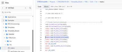

I thought there may be a configuration issue from my side. So I ran the "Starter project" provided by STM located at "STM32CubeN6\Projects\STM32N6570-DK\Templates_Board". This code also runs fine in debug mode. It does not work when flashed to external memory without commenting out "MX_ICACHE_Init();".

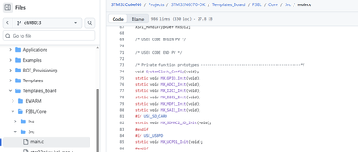

I cannot see MX_ICACHE_Init(); in the example "STM32CubeN6\Projects\STM32N6570-DK\Templates_Board"

ST released v1.3.0 for STM32CubeN6 MCU Firmware Package 3 days ago (23rd Jan 2026), which does not have MX_ICACHE_Init();. As expected this code runs properly after building and loading to the external flash.
v1.3.0
v1.2.0 does have MX_ICACHE_Init();
Nevertheless the question remains; Why am I unable to use v1.2.0 with MX_ICACHE_Init()?

The MX_ICACHE_Init() initializes the AXI Cache which is used to improve the performance of the data traffic when the NPU (Neural Processing Unit) accesses them thru AXI (section 12 of the RM).
To enable the Cortex cache (the 'usual' cache let's say), Cortex functions must be used: SCB_EnableICache() and SCB_EnableDCache();
In the starter board project, the NPU is NOT enabled, this is why there is no use to call MX_ICACHE_Init(), and so it was removed from STM32CubeN6 v1.3.0 (it was incorrectly present in v1.2.0).
