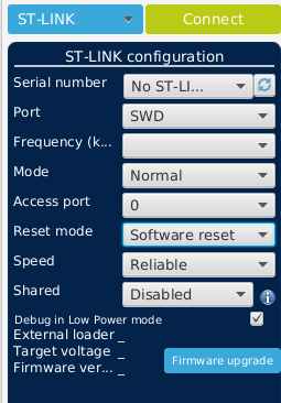

hey, I'm developing a custom stm32f405rgt6 board. I'm using stlink for uploading code. I'm comparitively new to stm as i've only worked with blue pill. I get "Error: No STM32 target found! If your product embeds Debug Authentication, please perform a discovery using Debug Authentication" this issue whenever i try to connect with stlink. i was not able to connect even once. I'm attaching the schematics below. I'm getting please help me solve the issue.

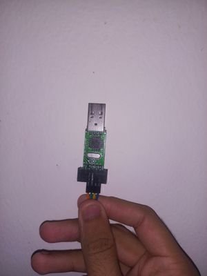

I have ST link V2 mini programmer and it has stm32f103CBT6 ic.
i regularly connect my blue pill using it.
BOOT0 is connected to ground through 47k resistor. and i also have connected a button to boot0 to make it high if necessary.
That's a clone / counterfeit ST-LINK, don't expect a lot of support / concern related to fixing issues with that.
The error basically means the connection is non-viable, frequently what you're connecting too and power supplies. Code you put on the device can also impede connectivity, ie reassigning pins, or turning off pins/circuitry require in low-power operation. Assuming you're seeing this on new boards, with blank devices.

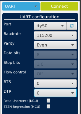

One more thing to try, see if you can at least activate the bootloader and connect to it with STM32CubeProgrammer.
I don't see a USB connector on in the schematic - so over UART (make sure you're connecting your USB->Serial cable to the right pins). If that works, you at least have a backup for programming the chip (though without debug, you'd have a hard time developing).

Will the programmer detect stm32 ic while using serial communication?
No. (not your clone...)
Need an (any) USB-serial adapter, rx/tx connected to the pins with uart/boot function.
Then connect in Programmer to uart ->
Did you try to connect under "software reset" ? Try. (your clone has no working reset for stm32, usually.)
If you're STM32 is otherwise functional (I mean if the problem is only with the SWD interface), it should.
Late Update: by "programmer" I meant "STM32CubeProgrammer" should be able to connect over UART. if by "programmer" you were asking if the ST-LINK will connect, then no, that's the whole point. It uses the SWD interface. You need to connect USB-Serial Cable and use that connection (UART mode) in STM32CubeProgrammer to connect to the board.
