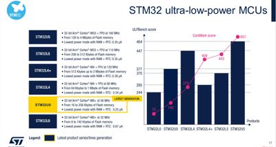

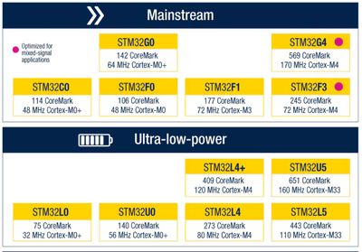

STOne-32
Dear @mlac ,
Welcome in STCommunity, Here is my suggestions our STM32 family offer different options of MCUs and our longevity program is extended each year by +10 Years.
You refer here to see a 20 to 32 pins MCU range : https://www.st.com/en/microcontrollers-microprocessors/stm32-32-bit-arm-cortex-mcus.html
I would suggest either a STM32U0 MCU running at 56MHz if ultra low power is key - battery operation or to select an STM32C0 MCU  for price sensitive both series are less then 2 years from launch and benefit from our latest improvements and peripherals and features including software.
Hope it helps you in the decision.
Ciao
STOne-32

I must decide on the exact MCU, so let me elaborate on my application.
I have multiple different devices collecting sensor data:
  • device A uses a capacitive I2C touch sensor
  • device B uses an optical SPI sensor
  • device C uses a PS/2 force sensor
  • device D scans a key matrix
On all devices, the sensor data is regularly updated and transferred via UART to a master device. Depending on usage, these updates can happen in several seconds or milliseconds. The devices must always listen to incoming UART payloads.
These devices are battery-powered, potentially for months on a single charge, so power consumption matters.
2K RAM and 16K flash are sufficient. Our application is not demanding, and driving an MCU at 1 MHz would probably suffice.
Q1: Roughly how much power can we save with an ultra-low-power part compared to a regular STM32C0 part?
Q2: Are you recommending the STM32U0 over the STM32L0? If so, why?

A1) I believe in this use case . STM32C0 is enough - Cost is key on C0 family
A2) ULP family is used in general when more than 95% of time the MCU is in standby or STOP mode , a bit expensive to have that premium less nA / uA
 U0 is only natural upgrade of L0 series with refreshed features of performance and security.
Have a great day
ST1
