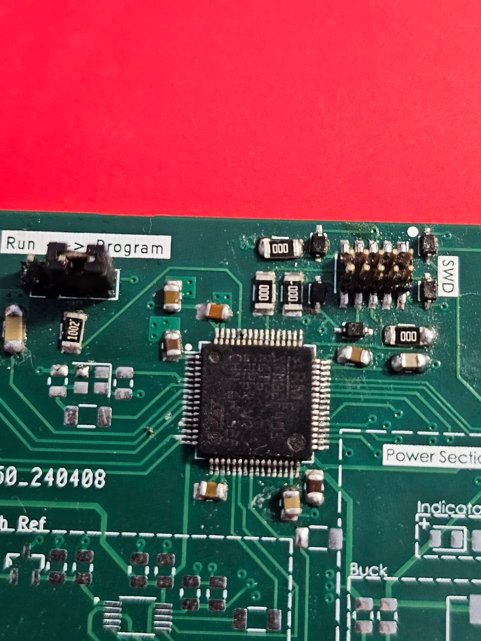

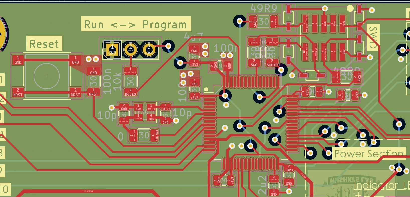

I am facing a problem that I spent A LOT of time on. I designed a custom board featuring the STM32F405RGT6 but i cannot connect to it at all.. I will attach the schematic and the board's pictures below. (The schematic is a PDF where I attached the sheet of the MCU's circuitry only there are other sheets for other parts of the board)
Things to mention:
1- I've assembled the board myself (But i checked the connectivity and voltages on the necessary nodes by a multimeter and i tested on the chip's pins not on the PCB pads and got the following:
-VDD on all VDD pins are 3.31V (measured directly on the pins)
-VDDA is also supplied by the same source with around 3.31V (measured directly on the pins)
-Vcap1 and Vcap2 are both 1.26V (measured on the the two Caps of 2u2 value)
-Reset Pin is 3.31V
2- I got suspicious about the SWD pinout that i did so i used an adapter and a Nucleo board's ST-Link to connect to my board where I measured the resistance between the SWD Pins and the Nucleo board and all are connected with reasonable resistance (Under 10 Ohms) (I got so desperate of the cause that I replaced the termination resistors of 49R9 with 0Ohms ones)
3- I got in both modes of Boot0 being Low and High. (Boot1 is floating would that cause the lack of connectivity?)
Am I missing something?!
Any kind of help would be much much appreciate. Thank you in Advance.

AScha.3
boot1 floating ... why ??
So you can not use bootloader, boot0 has to be low .
Thank you for your reply,
I've soldered a wire and i pulled boot1 low through a 10k resistor.. and then tried to pull it high .. but with the same result.. would this mean that my chip is dead?
Would it be dead even if i see the reset pin voltage as expected and both vcaps1&2 showing proper voltage? What do you think is the issue here?
Seems everything ok (if boot0 lo ! ) , should work.
Maybe you puzzeled the swd pins ? (mirrored pinout .... i have workmate, that "loves" to do this. But always 100% sure, he did right. )
Try connection with CubeProgrammer ... best, to see, whats going on.
Show, what it tells or shows.
I did miss up the swd pins.. however i connected the wires one by one (out from the adapter) to the st-link section of a Nucleo board (I tested this to identify a bluepill board which it did successfully).. and i tested with a continuity test from every single pin to the swd header on the Nucleo board
then i tried with my custom board but it didn't work.. it's very frustrating
So you still have a very basic / *** error there.
What shows CubeProgrammer with your board ? ( show screenshot.)
