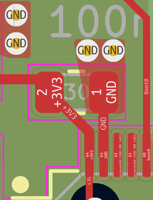

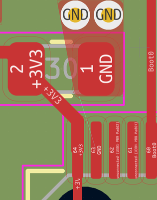

But primary mistake is missed pin 63 VSS on you schematics.
Hi again,
You're right pin 63 is not given in the symbol, However, it is actually connected. I checked the PCB viewer and it's present:
 And then i tried to delete the track to check if the RatsNest is connected, and yes it is, maybe the symbol has pin 63 connected internally or something,, I don't know:
I then did a continuity test from ground to pin 63 of the IC (Not the Pad) and it shows a good connection with 0.3Ohms.

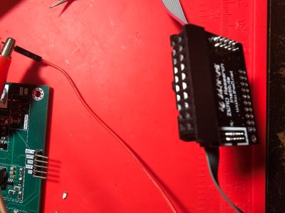

*If you mess up the swd connections for some reason like i did.. and you try to breakout the connections from the socket: The. Pay attention that some wires might be shorted to GND more likely in the connector as it has the original ground channel shortdd to other channels .. so after i messed up and put the SWCLK in one of the grounds it got shorted to ground whenever i connected the connector to the board... so, even if you test these connection to the MCU (i mean swdio and swclk) also check if they got shorted to other channels by the connector: and here's the connector I've been referring to:
You are the man @AScha.3 .. I already mentioned that I messed up the swd before but i took the wires from the adapter and mapped them and (continuity-tested all the pins that they're connected to their respective pins or no..) but as it turns out, for some reason (the place where i had my SWCLK in the adapter was already shorted to ground (inside the adapter itself cause i think there are multiple ground channels in it) .. so no matter how many times i check for shorts while the connector is disconnected nothing is wrong, but once i connected the connector .. the SWCLK gets shorted to ground and is forced to stay low, I've removed the swd connector and directly soldered VDD, SWCLK and SWDIO .. and ground ofc... and it's finally connected !!
