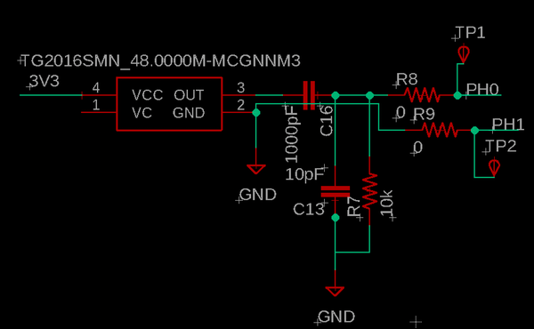

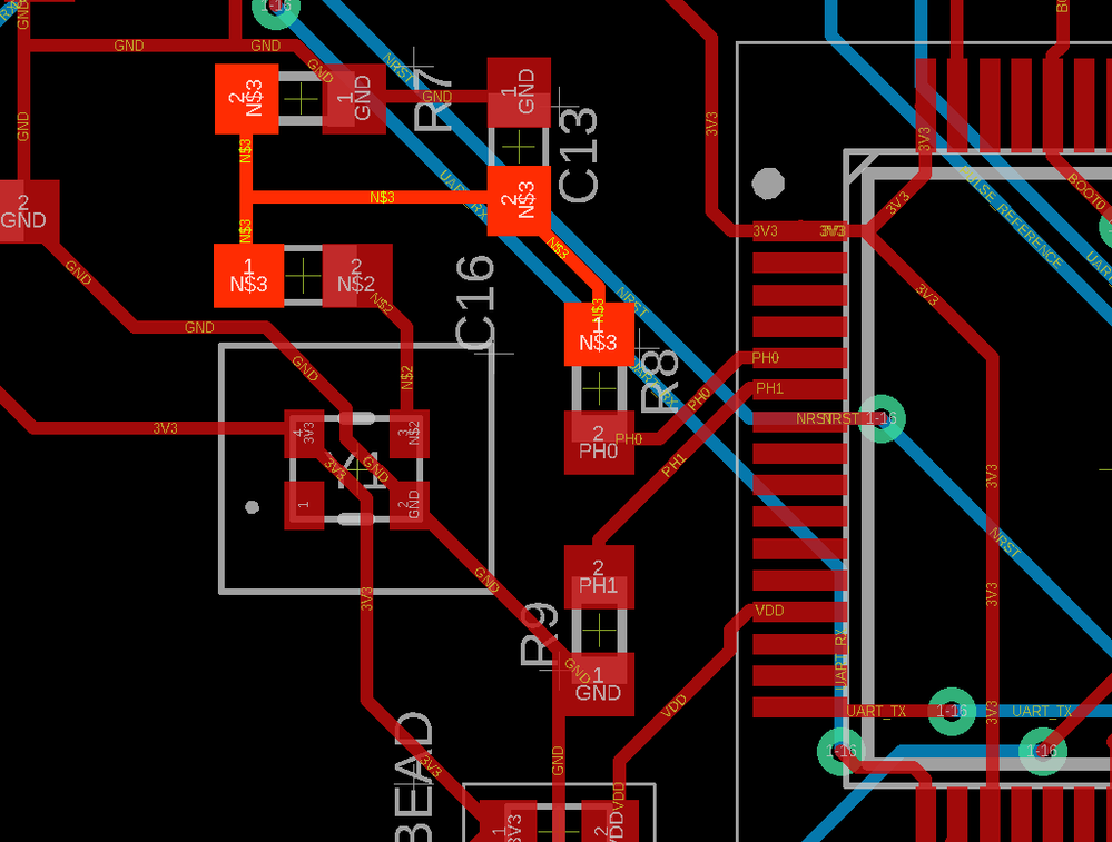

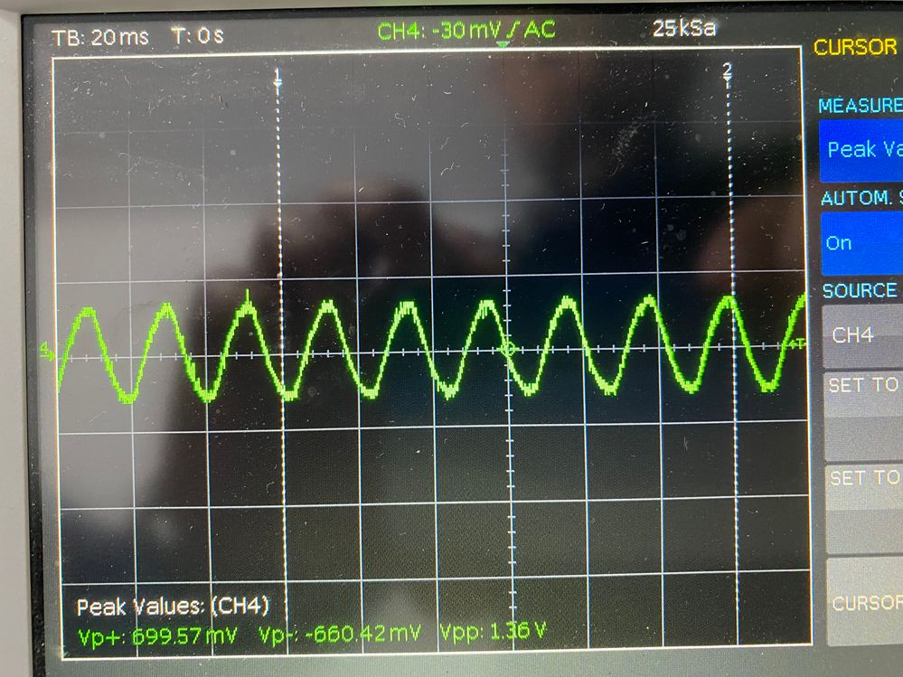

I’m designing a board with the STM32F401RBT6 and have decided to use a 48 MHz TCXO for the HSE clock.
I’ve written a simple "Hello World" program that communicates through USART.
the TCXO i used : TG2016SMN 48.0000M-MCGNNM3
Observations: When using the HSI (internal oscillator), the program works fine. When switching to the HSE (with the TCXO), the program does not work. I measured the TCXO OUTPUT SIGNAL using an oscilloscope. The waveform is shown in the attached image.image00001.jpeg
 value of R8 and R9 = 0 , C13 = 10 pF , C16 = 1000pF
What could be causing the program to fail with the HSE clock? Are there any specific considerations or configurations required to use a TCXO with the HSE input on this MCU?

Dear @Alaeddine_Chamsi ,
Welcome in STCommunity and thank you for sharing your use case .
1) Can You try to remove R9 so to leave PH1 Open .
2) by software, did you switched the HSE ON and in bypass mode ? Out of reset as you have seen HSI is always ON .
3) How do you know the program is not working ?  Can you share where the code is stuck ? Using the debugger . You can put a LED blinking infinite loop and let us know .
Hope it helps you .

Dear @STOne-32 ,
Thank you for your warm welcome and for taking the time to guide me through my issue.
I appreciate your suggestions and have reviewed them in detail. Below are my responses and additional details:
1) I tried removing R9 to leave PH1 open as you suggested and nothing changed.
2) Regarding the software configuration, I have enabled HSE and set it to bypass mode. Please find my SystemClock_Config code attached below for your review.

With MCU capacitor on OUT is fail. Replace C16 with 0-33R

The timebase on your oscilloscope is set to 20ms / division. That will not show 48MHz.
What you are showing is the waveform aliased-down by the 25000 samples per second sampling-rate that your oscilloscope uses when running at such a slow timebase.
You need to increase the oscilloscope timebase to something like 0.1 microseconds per division to have a hope of seeing the waveform (or better 0.02 microseconds per division if your oscilloscope will go that fast).
And the other thing is that the voltage you present to PH0 needs to swing from below 0.3 x Vdd to above 0.7 x Vdd, so that means that at a typical 3.3V supply it needs to swing from below 0.99V to above 2.31V.
The schematic shows you AC-coupling the output of the oscillator and biasing it around 0.0V (C16 and R7). And then C13 attenuates the signal. This will not work.
Remove all three of those components. Instead of C16 fit a resistor (you can use R7 if that's convenient).
Thank you for your detailed explanation! I tested this on two boards:
  1. On the first board, I removed C16, C13, and R7 as you suggested. The signal on PH0 now swings from -370 mV to 1.20 V (shown in Picture 1).
  2. On the second board, I only removed C16 and kept R7 and C13, since the TCXO datasheet recommends this RC load. In this case, the signal swings from -290 mV to 1.10 V (shown in Picture 2).
Would you have any suggestions on how I could improve this further? I really appreciate your guidance! :smiling_face_with_smiling_eyes:
removed C16, C13, and R7removed C16, C13, and R7only removed C16 and kept R7 and C13only removed C16 and kept R7 and C13
Primary switch scope to 1:10
1:1 is limited around to 10MHz
And still your connection to MCU is fail. For active TCXO R9 / PH1 must be unconnected
thank you for your response, R9 is already removed in both boards and i I have enabled HSE and set it to bypass mode.
