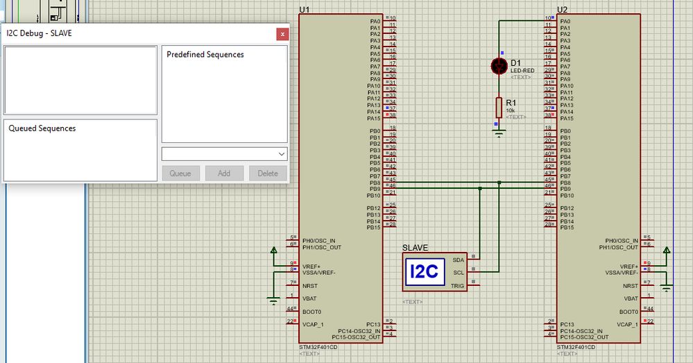

I want to use two STM32F401xx MCU in proteus. One of them is to be a master and the other is to be a slave.
This is my code for the master:
#include <stdint.h> #include <stdio.h> uint8_t temp=0; void begin(); void end(void); void Write (uint8_t); void star(void); void address(uint8_t addr); uint8_t value = 0x00 ; void main() { begin(); star(); address(0x08); Write(0x01); end(); } void begin(){ //join I2C as a master mode RCC_APB1ENR |= (1<<21); // enable I2C CLOCK RCC_AHB1ENR |= (1<<1); // Enable GPIOB CLOCK // Configure the I2C PINs for ALternate Functions //PB8 and PB9 are connected to I2C1_SCL and I2C1_SDA GPIOB_MODER |= (1<<16)|(1<<18); GPIOB_OTYPER |= ((1<<8) | (1<<9)); GPIOB_OSPEEDR |= ((3<<16) | (3<<18)); GPIOB_PUPDR |= ((1<<16) | (1<<18)); GPIOB_AFRH |= ((4<<0) | (4<<4)); // Reset the I2C I2C1_CR1 |= (1<<15); //I2C Peripheral under reset state -->page.493 manual I2C1_CR1 &= ~(1<<15); //I2C Peripheral not under reset -->page.493 manual // Program the peripheral input clock in I2C_CR2 Register in order to generate correct timings I2C1_CR2 |= (42 <<0); // PCLK1 FREQUENCY in MHz I2C1_CCR |= (210<<0); // Configure the clock control registers I2C1_TRISE = 43; // Configure the rise time register I2C1_CR1 |= (1<<0); // Enable I2C } void star(void){ //Generate a start condition I2C1_CR1 |= (1<<8); // Generate START while (!(I2C1_SR1 & (1<<0))); // Wait for SB bit to set to 1 } void address(uint8_t addr){ I2C1_DR = addr; // send the address while (!(I2C1_SR1 & (1<<1)));// wait until the address recieved success temp = I2C1_SR1 | I2C1_SR2; //clear ADDR } void end(void) { I2C1_CR1 |= (1<<9);//stop generation // Wait until the STOP condition is complete while (I2C1_SR2 & (1<<0)); //Cleared by hardware after detecting a Stop condition on the bus // Clear the STOP bit I2C1_CR1 &= ~(1<<9); } void Write (uint8_t dat) { while (!(I2C1_SR1 & (1<<7))); // wait for TXE bit to set I2C1_DR = dat ; // wait for BTF bit to set while (!(I2C1_SR1 & (1<<2))); //waiting while BTF=0 but when BTF=1; Data byte transfer succeeded }

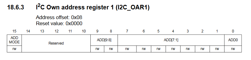

#include <stdint.h> #include <stdio.h> uint8_t temp=0; uint8_t state =0x00; void begin(uint8_t addr); void end(void); uint8_t Read (); void main() { RCC_AHB1ENR |= (1<<0); // Enable GPIOA CLOCK GPIOA_MODER |=(1<<0);//set pin 0 as output begin(0x08); state = Read(); end(); if (state == 0x01){ GPIOA_ODR |=(1<<0);//set 1 for pin 0 } } void begin(uint8_t addr){ RCC_APB1ENR |= (1<<21); // enable I2C CLOCK - RCC_AHB1ENR |= (1<<1); // Enable GPIOB CLOCK // Configure the I2C PINs for ALternate Functions //PB8 and PB9 are connected to I2C1_SCL and I2C1_SDA GPIOB_MODER |= (2<<16) | (2<<18); GPIOB_OTYPER |= (1<<8) | (1<<9); GPIOB_OSPEEDR |= (3<<16) | (3<<18); GPIOB_PUPDR |= (1<<16) | (1<<18); GPIOB_AFRH |= (4<<0) | (4<<4); I2C1_CR2 |= (42 <<0); // PCLK1 FREQUENCY in MHz I2C1_CCR |= (210<<0); // Configure the clock control registers I2C1_TRISE = 43; // Configure the rise time register I2C1_CR1 |= (1<<0); // Enable I2C //join I2C bus as a slave mode I2C1_OAR1 = addr;//own address interface I2C1_CR1 |= (1<<0); // Enable I2C I2C1_CR1 |= (1<<10); // Enable the ACK ,indicate that a byte is received } void end(void) { I2C1_CR1 |= (1<<9);//stop generation // Wait until the STOP condition is complete while (I2C1_SR2 & (1<<0)); //Cleared by hardware after detecting a Stop condition on the bus // Clear the STOP bit I2C1_CR1 &= ~(1<<9) } uint8_t Read (){ uint8_t receivedData = 0; I2C1_CR1 &= ~(1<<10); // clear the ACK bit temp = I2C1_SR1 | I2C1_SR2; // read SR1 and SR2 to clear the ADDR bit.... EV6 condition I2C1_CR1 |= (1<<9); // Stop I2C while (!(I2C1_SR1 & (1<<6))); // wait for RxNE to set receivedData = I2C1_DR; // Read the data from the DATA REGISTER return receivedData; }
View more
when i run the simulation there is nothing happened , the LED still off and PB8 , PB9 haven`t change , i want to know , if there any problem in my provided code, I followed the datasheet and manual of STM32F401xx to write this simple driver. is this the correct address will be passed to begin(addr) ?
and this is the simulation connection in proteus:

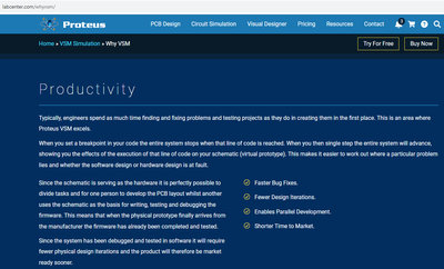

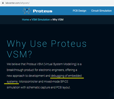

You're using Proteus - so you have both software & hardware debug facilities available to you...
https://www.labcenter.com/tutorials/
https://www.youtube.com/@LabcenterElectronicsLtd
