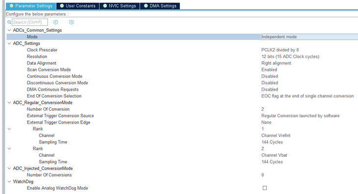

During simple task I need to measure Vrefint and Vbat, so, I open CubeMX and configure ADC to read Vrefint and Vbat

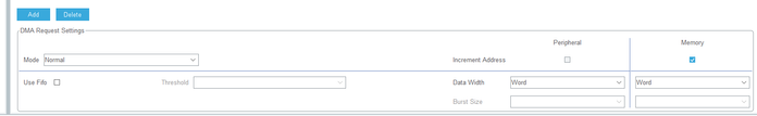

Than I setup a DMA to read values...
I write a really simple program:

But I faced with really strange issue

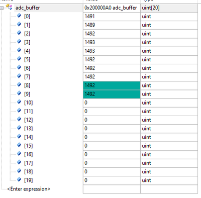

When I configure Rank1 and Rank2 as Vrefint and run my program I get such results (i.e. ref value is 1492)
(value stored at 0x1FFF 7A2A close to this value, so, reading is correct)

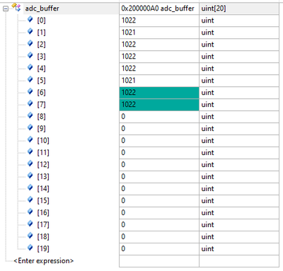

When I configure Rank1 and Rank2 as Vbat and run my program I get such results (i.e. Vbat value is 1021)

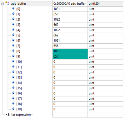

But when I configure Rank1 as Vbat and Rank2 as Vrefint I get such values (also I can configure Rank1 as Vrefint and Rank2 as Vbat):
i.e. Vbat is 1021 (as previously) and Vrefint is 656 (previously 1492)

I can remove Vbat from measuring and add more ADC channels to sequence (like IN0, IN1, Vrefint, IN4) - in this situation I get Vrefint 1492, but when I add Vbat to such sequence (i.e. IN0, Vbat, IN1, Vrefint, IN4) I get Vrefint as ~600, or some other values, but never 1492

waclawek.jan
This is consequence of a bizarre limitation in some (most?) 'F4, that you need a software intervention - switching on/off ADC_CCR.TSVREFE and ADC_CCR.VBATE - between measuring VBAT and VREFINT (and internal temperature sensor).
Previously I try manual switching, but it doesn't help
But now I know where to look at :)
Thanks!
