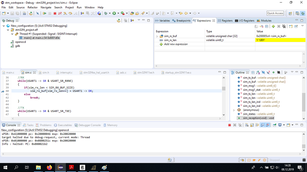

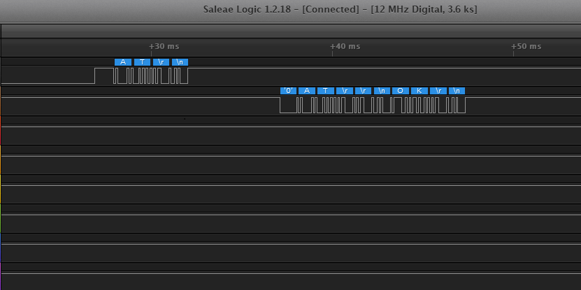

Transmitter works perfectly, I can send whole commands. As you can see I send one command and waiting for response.
As seen at the screenshot from logic analyzer after command "AT\r\n" SIM module send response.
But receiver in STM can't see it...

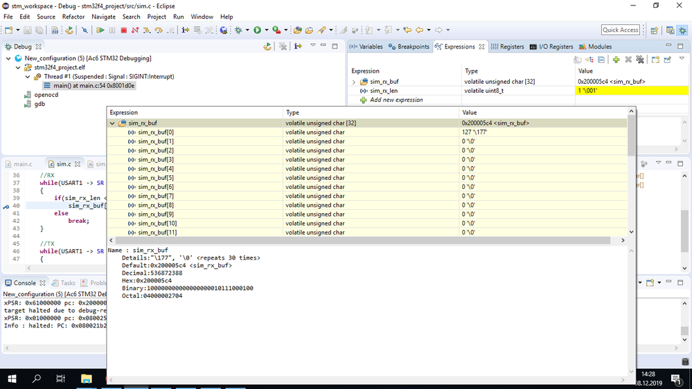

Screens from debugger
Microprocessor receive only one byte of value 127.
I have no idea what could be wrong.

I'd probably use a proper ring buffer.
Watch for other error status on the USART blocking reception.
Don't inspect the USART registers from the debugger.
