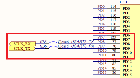

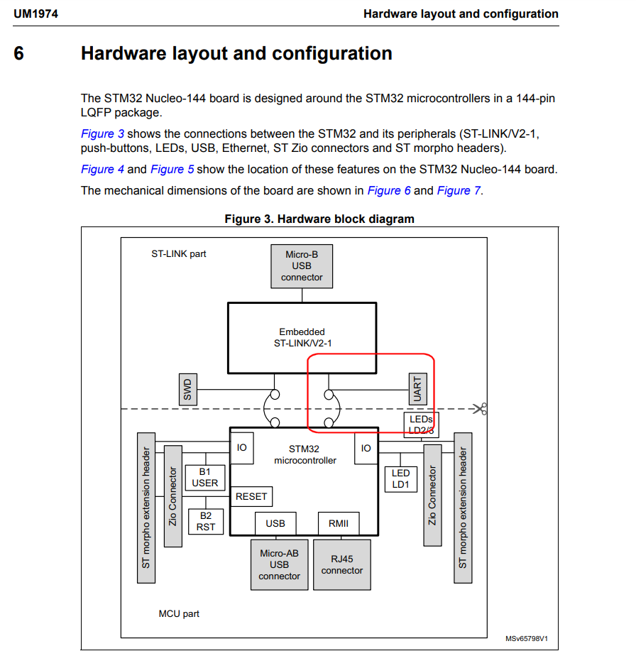

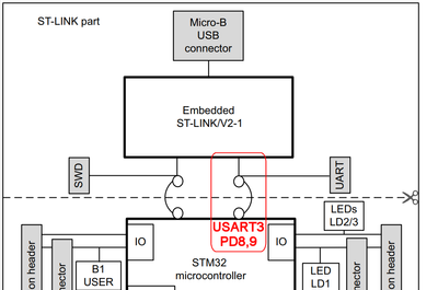

I'm using USART 3 with my computer via STLINK and communication is normal, but if I switch to using USART2 (PD5 is TX and PD6 is RX) and of course the code will also change from uart3 to uart2 but it won't transmit. receive.
If you are using USART2 with STLINK Virtual Comport, that will not going to work as that UART is not connected to the STLINK VIRTUAL comport as shown in the schematics I shared before.
So you need to use an external USB-to-UART module that will be connected to PD5 and PD6.
You need also to probe Tx and Rx with a logic analyzer or an oscilloscope to check where it goes wrong.

As pointed out by @mƎALLEm, that VCP is connected to USART3 (PD8 & PD9) on the STM32F4 microcontroller.
So, if you want to use USART3 to communicate with any external device, you are first going to have to disconnect it from the ST-Link VCP - that's what the SB5 & SB6 links are for:
https://www.st.com/resource/en/user_manual/um1974-stm32-nucleo144-boards-mb1137-stmicroelectronics.pdf#page=1
Of course, once you've disconnected them from the ST-Link, then you will no longer be able to communicate over the VCP - you will need a separate USB-to-UART converter.
Similarly, if you use any other UART connection than PD8 & PD9, that will not be connected to the ST-Link and, therefore, will not be accessible via the ST-Link's VCP -  so you will, again, need a separate USB-to-UART converter.
