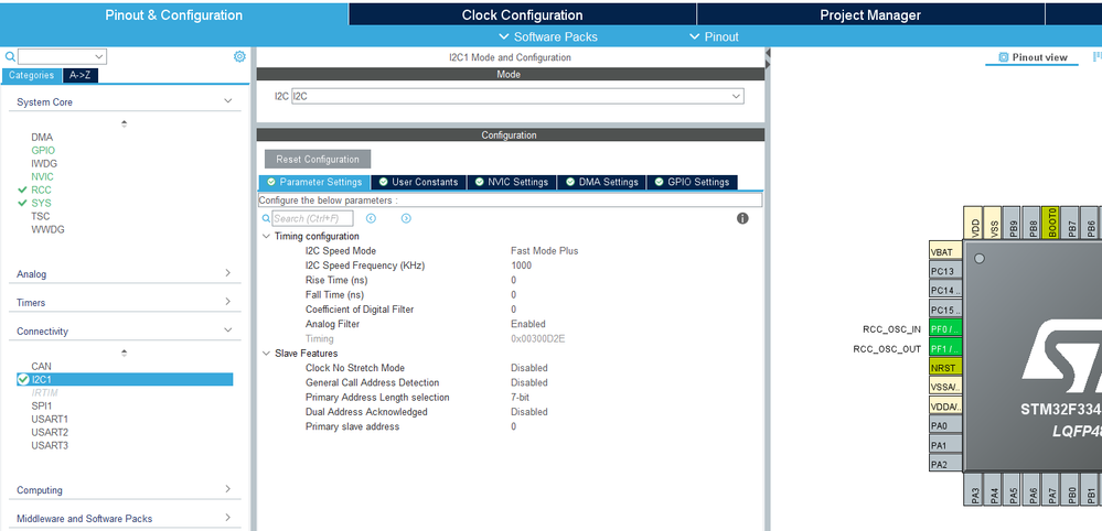

>how "I2C timing configuration tool " can help to set the timing reg in this situation ?

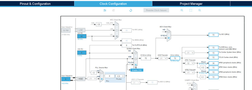

you can use STM32CubeMX for the configuration :
you can set 72MHz as a clock :
Hope I helped you!
