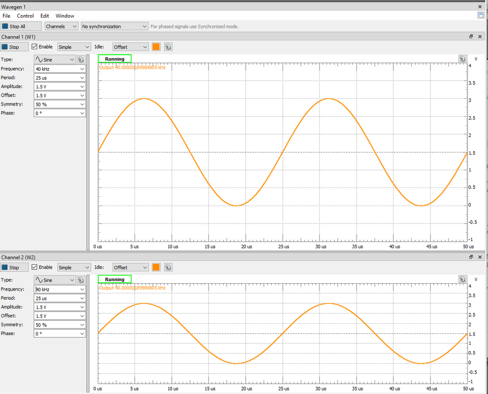

_legacyfs_online_stmicro_images_0693W00000bku8LQAQ.pngsnapshot of my function generator

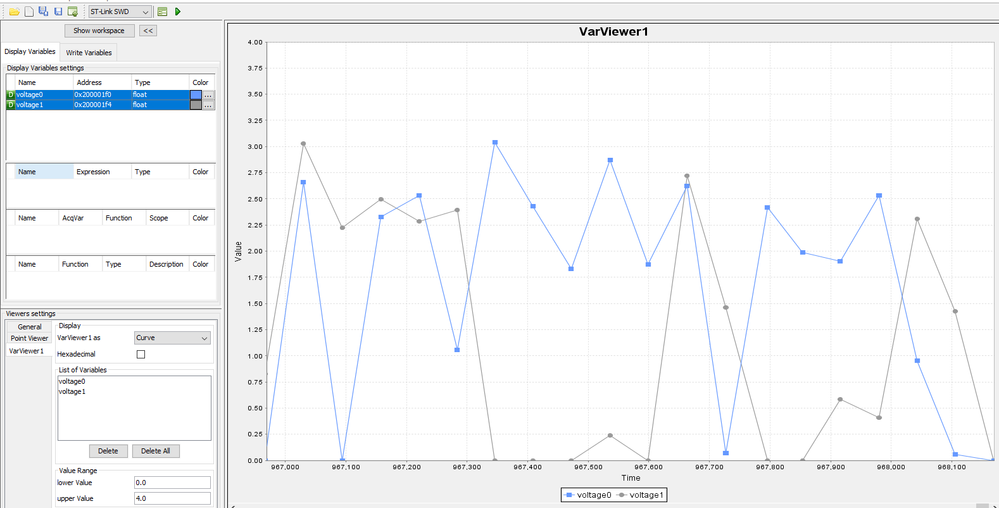

When i convert the DMA'd values back to voltages, i can't recreate the sinewaves again, with the STM Studio.
_legacyfs_online_stmicro_images_0693W00000bku8kQAA.pngsnapshot from STM Studio.
I use the formula to convert my adc values back to voltages.

Well, i didn't want to concentrate on the signal processing aspect. I simply wanted to get the signal representation in the digital form, then i can apply whatever methods available. FFT, or even apply FIR filters. But first, i want to get the signal in the digital domain. Thats the gist of the matter. Forget the signal processing aspect of it for a moment.

Try first with a much slower sinus wave so that reconstruction is straight forward. Reconstruction at the Nyquist edge is tricky.
