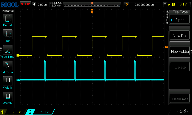

This is the scope image. Yellow trace is the timer output. All ADCs are triggered on the rising edge. The blue trace is the GPIO pulse generated within the ADC interrupt. According to this ADC conversion takes 2us from start to finish.

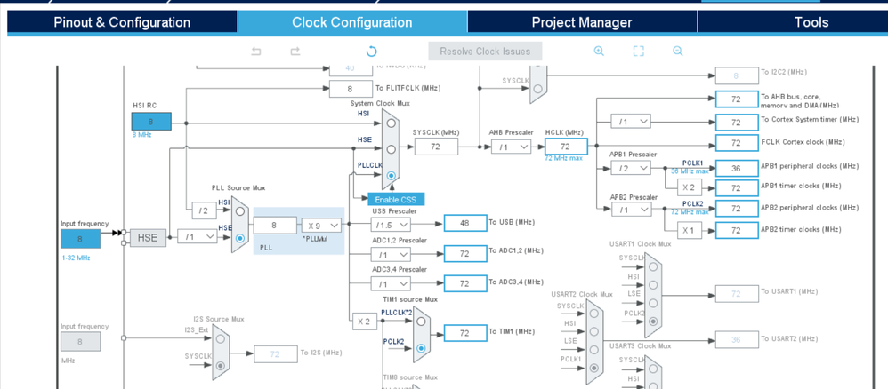

Recheck your setup? Are you really running at 72 MHz?I was able to use the F303 ADC as describes with the speed expected.

You can see the clock configuration above. It must be correct as the timer frequency is exactly the same as expected.

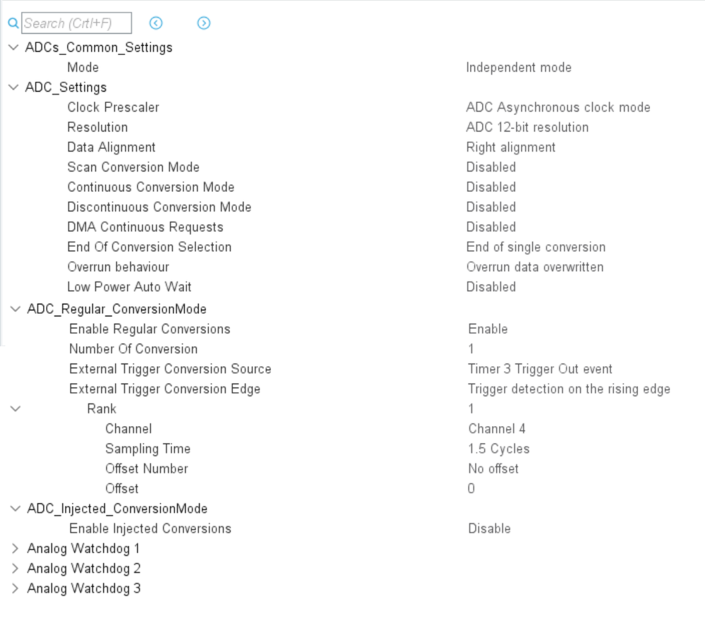

This is the ADC configuration for one of the ADCs.

Toggling a pin isn't going to give you accurate timing here. It will include overhead of the IRQ entry. That isn't enough to explain the entire delay, but it explains a chunk of it.
If you want to verify speed, do a bunch of conversions back to back, say 10000, use DMA to transfer, and measure the time it takes to complete. This will include minimal overhead.
