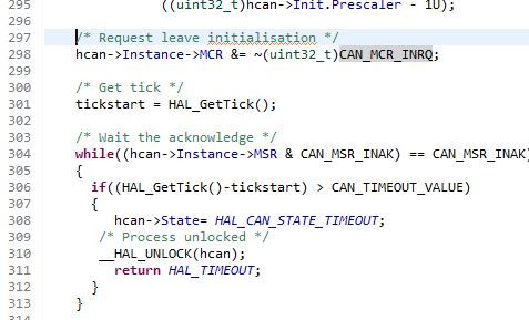

I apologize for the delay in responding, but I wanted to make sure I tried all the suggestions. At this point, I have built a new project and implemented all the code from the STM32F303C_Eval example project. I debugged, and found the
point that the code is failing. The code in the image below is from the stm32f3xx_hal_msp.c file. It is in the CAN_Init function.
On line 297, it puts out a call for a response, then waits for an acknowledgement on line 304. It never gets that bit set, even when I connect to a known working bus. I have two other devices communicating without error, and just listening for something from the nucleo.
