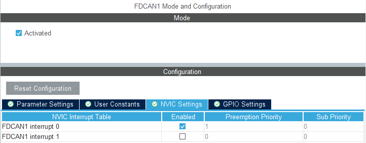

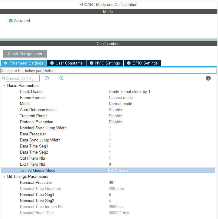

I am using STM32G431KBT MCU. I am using 2 MCU (master / slave) and they communicate via canbus. Canbus is working good but canbus filter is not working. Master canbus address is 0x200 ans slave address is 0x101. I changing master ID (0x150) but the slave still continues to receive data and go to the canbus callback program. Cubemx settings are as follows;
And program is here;

2-  You forgot to call HAL_FDCAN_ConfigGlobalFilter() after the filter config:
  if (HAL_FDCAN_ConfigGlobalFilter(&hfdcan1, FDCAN_REJECT, FDCAN_REJECT, FDCAN_FILTER_REMOTE, FDCAN_FILTER_REMOTE) != HAL_OK)
    Error_Handler();

I was beginning to think that there was a bug in cubemx or the HAL libraries, so I manually added the following lines to the program. It worked when I added these lines.
    volatile uint32_t *rxgfc = (volatile uint32_t *)(0x40006400 + 0x0080); // 0x40006480
    *rxgfc = (1 << 5) | (1 << 16); // F0OM = 1, ANFS = 2, LSS = 1
But I missed the "HAL_FDCAN_ConfigGlobalFilter".Thanks @mƎALLEm, It's working.
