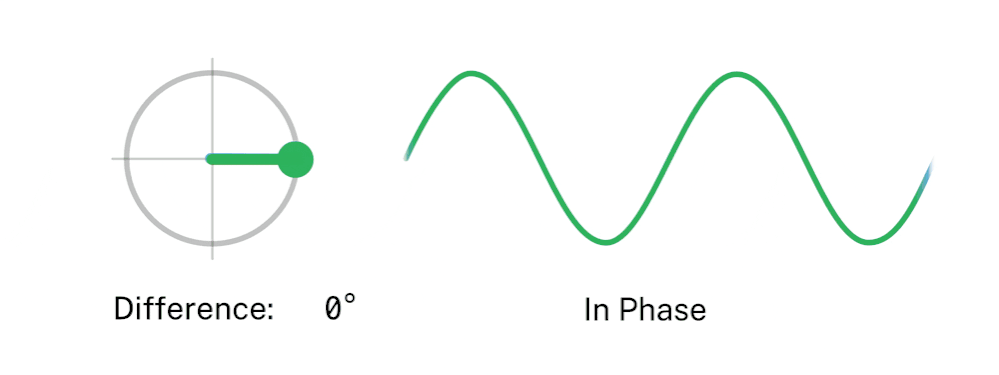

You could perhaps also show what you mean by "phase drift between my external oscillator output and an STM32 timer output on an oscilloscope". Screenshot or picture or something. I think I understand what you're saying but sometimes the picture can clear up assumptions.
‎2024-02-01 6:35 PM
This is sort of what I'm seeing but the phase difference is constantly changing. I'll do more debugging tonight.

Sorry, I am a bit confused:
You want to configure some timers (TIMs) and verify if their generated clock outputs are in sync with the external HSE oscillator? (expecting a constant phase relation?)
If the TIMs and all the TIM blocks get their core clock via HSE -> PLL -> TIM - how could they be in sync if a PLL is involved?
It can only work, if you can grab the TIM clock directly from the HSE input - without any PLL involved.
(a PLL will have a phase offset, and even a phase drift)
Is there an option to select HSE (directly) as clock source for a TIM? If not, e.g. via a PLLx (which comes from HSE via PLLM but after a PLL) - I would assume these signals are never phase synchronized (and the phase can drift).
‎2024-02-01 8:51 PM
Not sure this really clears much up. Signals you're looking at should be square waves, not sine waves. The figure you attached looks like jitter, not drift. Some amount of jitter is to be expected due to the PLL.
