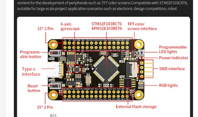

STM32F103RC
ICM20607
MPU6050
YAHBoom
YB-MSA02-V1.0
STM32F103RC
https://category.yahboom.net/products/yahboom-stm32-core-board?variant=44861119332668
ICM20607 that is on board.
MPU6050, I don't use this. Because ICM20607 has the same function.
@Tesla DeLorean
Right, so it says that board already has a CH430 UART-to-USB chip to give UART comms via the Type-C connector.

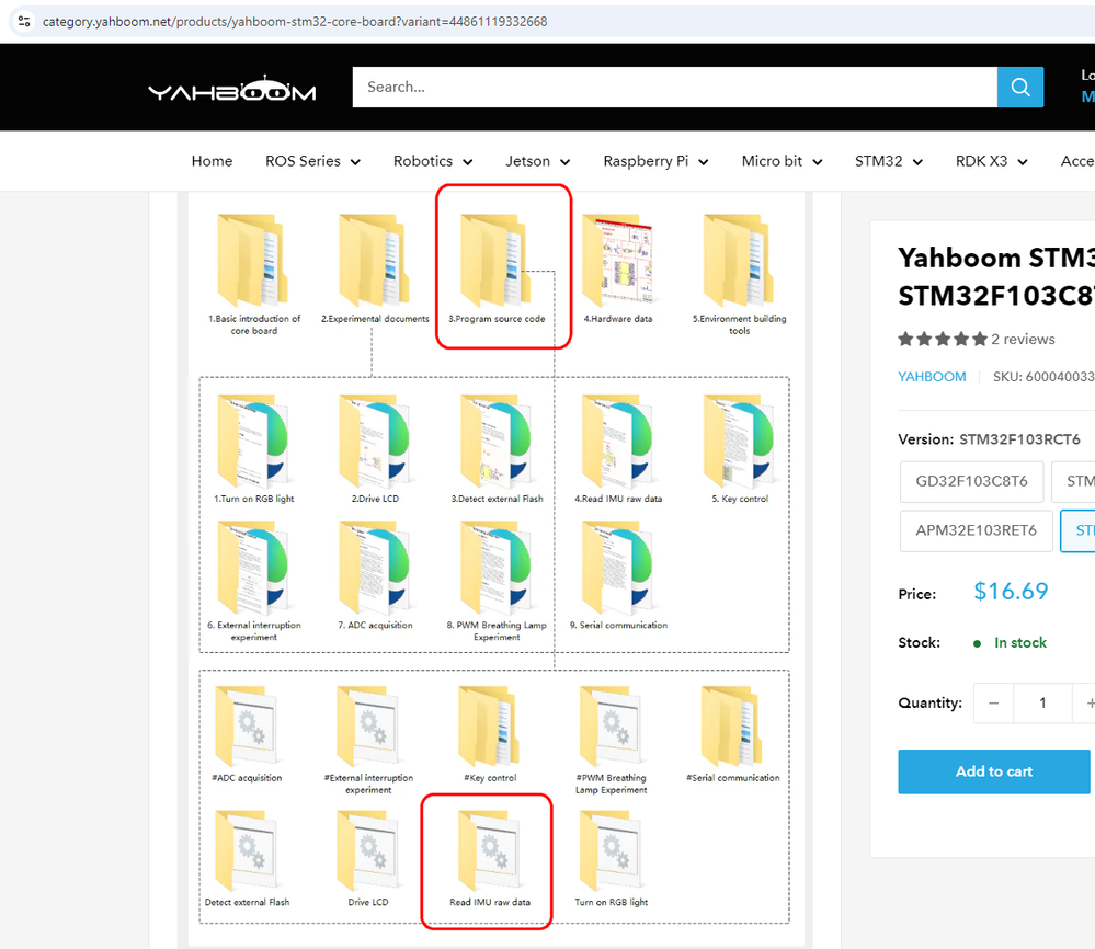

Andrew Neil
@stmuser3535 wrote:
 I want to read the accelerometer data
Have you tried the supplied code?
@stmuser3535 Thanks, in future lead with this information when you open your questions so the context can be better understood, and you'll get better / quicker answers.
