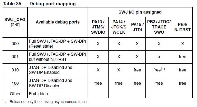

In 'STM32F1 getting started hardware development' application note , you can see that PB3 is used by the SW debug port. PB5 and PA15 are only used by JTAG, this is why you can use them as GPIO pins by disabling the JTAG and keeping the SWD enabled.
If you want to use PB3 pin, you must also disable the SWD.

Isn't PB3 (SWO) part of the SWD connectivity?
The SPL example demonstrates the use of PB3
STM32F10x_StdPeriph_Lib_V3.5.0\Project\STM32F10x_StdPeriph_Examples\GPIO\JTAG_Remap\main.c
/* Disable the Serial Wire Jtag Debug Port SWJ-DP */
GPIO_PinRemapConfig(GPIO_Remap_SWJ_Disable, ENABLE);GPIO_Remap_SWJ_JTAGDisable should allow PB3 to be used if Trace isn't used or negotiated by the debugger. The usability here may strongly depend on the specific debugger pod and debugger software being utilized, which isn't mentioned here.

Yes, PB3 can be used as trace data output (asynchronous trace). That's why I explicitly took care to have trace turned off (via DBGMCU_CR), even though it's off by default after reset. I didn't find any other function that could use PB3 with a higher priority (except for JTDO which is disabled as well).
I can't turn off SWD completely since that's the only access to my boot loader. However, from all known documents it should work perfectly fine with only JTAG turned off (and SWD enabled) by AFIO->MAPR. I don't use the SPL but simply write to that register directly.
I don't use debug in this case (it's also impossible due to r/w protection of the flash, BTW), so from all those documents PB3 should be available as GPIO - however it just doesn't work. (Opposed to PB4 and PA15 which work exactly as documented.)

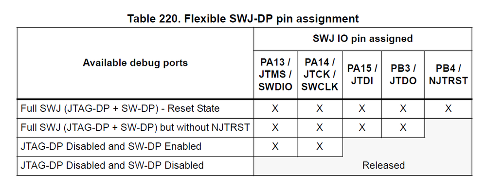

‎2016-12-14 10:18 AM
That really isn't what the RM0008 manual says...
‎2016-12-14 10:21 AM
Hello Lawliet,
if that is true, it is indeed a bug - see Table 220 in the RM (on page 1086, below). It is clearly specified that PB3 is released as GPIO as soon as JTAG is disabled.
