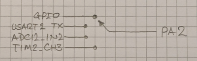

Probably a more useful description would say that the various different functions are multiplexed onto a pin; eg, for PA2 (from the datasheet extract posted by @mƎALLEm:(

@braveyav wrote:
I see that the PAx pins (PA0–PA15) have multiple alternate functions !
Not just the PAx pins - also some PBx on this particular chip.
In general, any PXy pin could have multiple alternate functions.
waclawek.jan
Going one step further, the switch as drawn by @Andrew Neil above can in fact be broken to two switches: one selects between GPIO (more specifically, GPIO output) and the input to the other switch, this is called Alternate Function. The second switch then selects between TIM, USART, ADC.
However, in STM32F1xx, the method *how* that function is switched, is different from all other STM32. It was the first STM32 family and ST did not figure out the right way to do yet. So, while in all other STM32 thre's a dedicated register to steer that second switch, in the 'F1 family, it's steered by whichever peripheral's clock is enabled in RCC. This is then further complicated by the need to select groups of pins associated to given peripheral, in the AFIO module.
