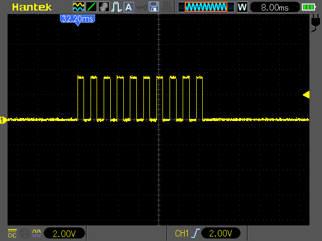

I will explain that I made for other people.
I would N pulses on PB10 (Timer 2 channel 3)
I use TIM2 in PWM mode to generate the signal on Channel3 and :
- Trigger Output (Master) : Enable
- Event Selection : Update Event
I use TIM4 in
- OnePulse mode,
- Slave Mode : Trigger Mode,
- Trigger source : ITR1 (it's TIM2 for TIM4)
after calculation for duration, speed, etc.
I start TIM4 with
- HAL_TIM_Base_Start_IT(&htim4);
and just the line below :
- TIM2 HAL_TIM_PWM_Start(&htim2,TIM_CHANNEL_3);
at the first front of TIM2 the TIM4 will start.
for the end, in the TIM4_IRQHandler I add the line :
- HAL_TIM_PWM_Stop(&htim2, TIM_CHANNEL_3);
