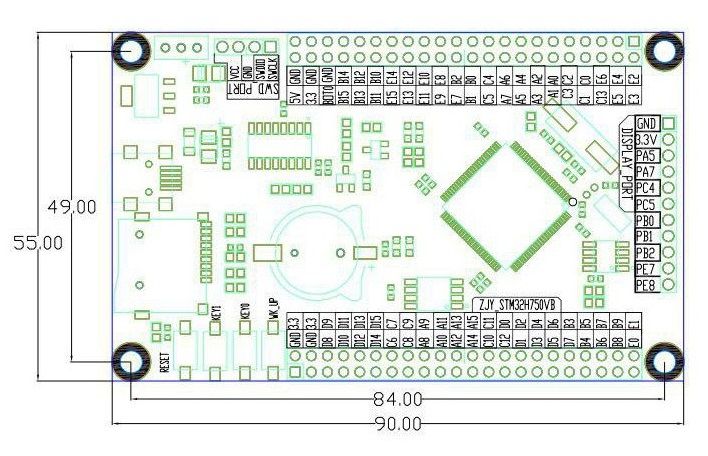

0690X00000AsLsgQAF.jpgOk, so have the H750 version of this board. The manufacturer is ZJY TECH

Haven't been able to get schematic from vendor. QSPI/SPI doesn't seem to be working on external FLASH, not determined connectivity there.
I think the H750 board is probably a good purchase, though I'd still go for the Nucleo board myself.
It's a shame about the flash (try checking the connections with a multimeter to see where they go).

So sadly the QSPI isn't usable on the chip provided, but could probably be wired as a socket
Bummer - the W25Q128 is only connected for standard SPI operation, not even dual-SPI at least.
Looks like a random-pick of pins for the SPI. I'd probably desolder the W25Q128 and wire it up to the QSPI pins.

I don't think it is a W25Q128, rather a W25X16AVSIG
I was hoping the board would have been clever, but can live with a breakout board with working MicroSD card
