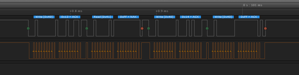

In which loop does the execution stall, in the very first check of SB bit, or later on? Can you see any activity on SDA or SCL with an oscilloscope?
As Radoslaw told in an other thread, using the symbols from the system header instead of ''magic numbers'' increases code readibility. JW- Mark as New
‎2016-02-16 8:43 AM
It stalls at line 126 of i2c.c
I just want to verify that the peripheral works as expected.- Mark as New
‎2016-02-16 8:46 AM
The program runs fine for hours. Bus activity is verified with a logic analyzer.
