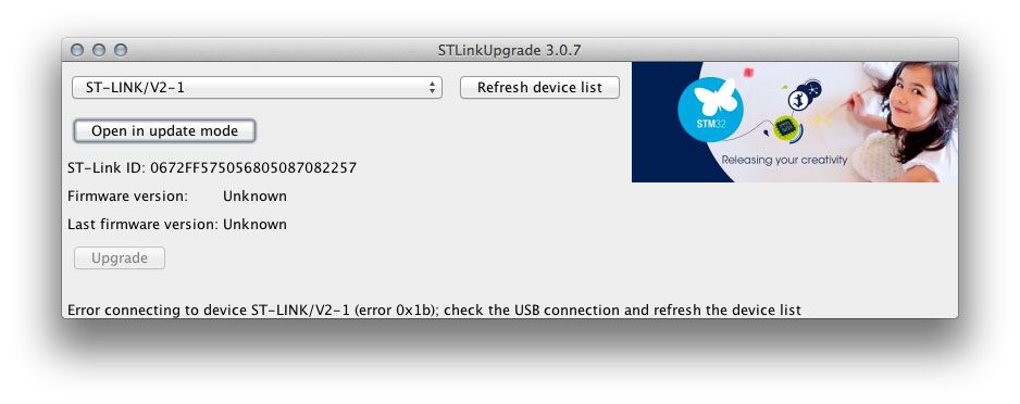

I've run into similar problems. Upgraded st link firmware on a Nucleo 144 board from V2J26M13 to V2J26M15 and the board is now unreliable.
With the older version (...M13) appeared to work okay with the st-link software under Mac OSX 10.11.3 but I couldn't confirm that debugging worked so I tried the new firmware.
The upgrade process failed (on the Mac) with a very similar error, after that the board was unrecognized by the upgrade tool.
I was able to eventually re-run the upgrade process (using the same ST supplied java upgrade tool) several from an Ubuntu 14.04 VM. The board appears to mostly work with st-link under Linux but remains hopelessly non-functional from a Mac.

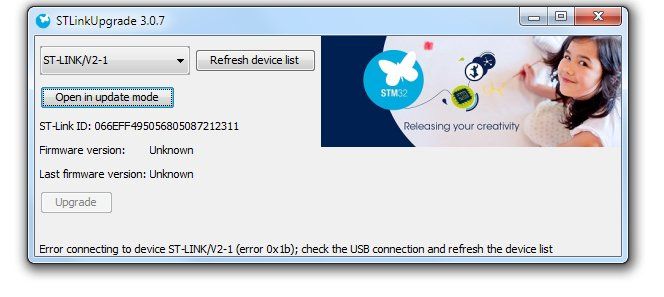

I can confirm the same issue and several people are reporting me the same problem. After updating the ST-LINK firmware to the latest 2.26.15, the ST-LINK interface nor longer works, and it's neither detected by the STLinkUpgrade.
This is the error message that appears:
The LD1 led remains fixed red while the STLinkUpgrade tries to connect to the ST LINK interface.
carmine
Posted on February 26, 2016 at 07:23
I've found a solution.
  1. Download this old ST-LINK firmware from
    https://www.dropbox.com/s/bm0cq4qo1mui1t0/stsw-link007.zip?dl=0
  2. Connect your development board to the USB interface.
  3. As said above by SC, do a quick shortcut between SB11 and RST pads (they are located on the bottom side of the board).
  4. Start the STLinkUpgrade 3.0.3 (the one downloaded before) and downgrade the firmware.
  5. Disconnect your Nucleo board from USB and reconnect it again.
Full instructions with pictures
http://www.carminenoviello.com/2016/02/26/restore-st-link-interface-bad-update-2-26-15-firmware/
S C
Posted on February 29, 2016 at 13:42
Hello cnoviello,
Thank you for your solution. The real problem has been identified, it happens on systems doing the USB command ''get device descriptor'' after the ''set configuration'', which seems common on MacOS at least. A fix is being prepared. Meanwhile the firmware at
http://www.st.com/web/en/catalog/tools/PF260217
 has been downgraded back to V2J25M14, and can now be used also as recovery.
Your workaround is the only solution on failing configurations. Another workaround is to downgrade the ST-Link firmware from another host where the issue is not present.
