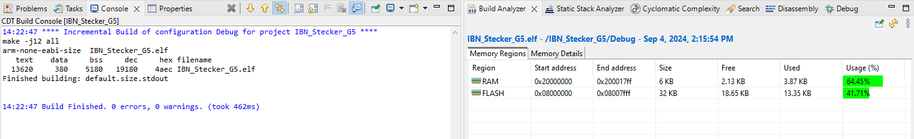

I am using the STM32F042K6 for a small project where I don't have much space. Therefore, I rely on the small package and the "crystal-less USB" function. The hardware arrived today, but unfortunately, I had to realize that the USB library seems to be too large for the chip. I created a new, empty project in CUBE IDE, with only I2C and USB (COM PORT) enabled, and I get the following error message:
"c:\st\stm32cubeide_.2.0\stm32cubeide\plugins\com.st.stm32cube.ide.mcu.externaltools.gnu-tools-for-stm32.10.3-2021.10.win32_1.0.200.202301161003\tools\arm-none-eabi\bin\ld.exe: Test_Project.elf section .data' will not fit in region FLASH'
c:\st\stm32cubeide_1.2.0\stm32cubeide\plugins\com.st.stm32cube.ide.mcu.externaltools.gnu-tools-for-stm32.10.3-2021.10.win32_1.0.200.202301161003\tools\arm-none-eabi\bin\ld.exe: region `FLASH' overflowed by 12 bytes"

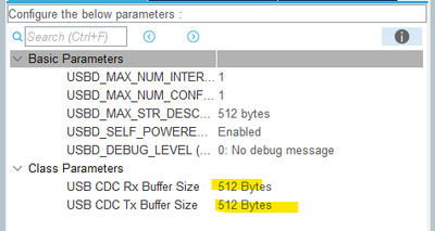

Looks like the CDC is using a lot of RAM. If you change the buffer from 1024 to 512, then it will fit.
  • Hopefully you don't have much user code especially RAM or you'll run into the same issue.
  • You'll have to work with a smaller buffer. Hopefully you don't need to transfer large amount of data.

Andrew Neil
What optimisation setting are you using?
Are there configuration options on the library to reduce its memory footprint (presumably, at the cost of functionality and/or performance)?

Sure, here it is. Brand new Project, no user code, only USB and I2C activated.
@PP11 wrote:
@Andrew Neil : What optimisation setting are you using?
I did not change anything in the default settings,
Then likely it's NO optimisation - so definitely start by adjusting that!
And a big +1 to @Karl Yamashita's suggestion to start developing on a bigger device - it's far easier to find optimisations in something that does build than in something that doesn't.
When it does build, you will have  a map file to look at to see where all the code space is going.

Hey Karl,
the optimization settings and lowering the buffer size does work, thanks for your help!
Greetings Paul
