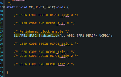

Im just getting my new STM32N6570-DK and I try blinking simple led project first with default generate.
But when I built and flash it, it got stuck when init UCPD (pic 1), am I missing something ?

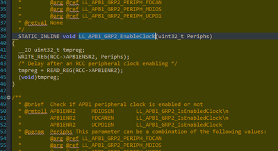

When I checking seem it still not define yet (pic 2).
Thanks

It appears you didn't configure UCPD global interrupt, DMA settings neither configure USB PD stack. I suggest you to start with example provided in CubeN6.

Hi @Micls
Would you attach your IOC file?

And one more thing is LED2 default is input mode.
Everything it generate default
